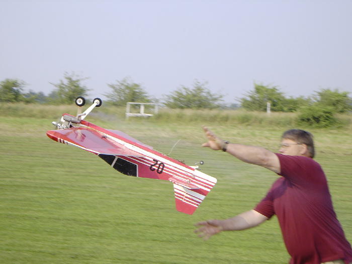

I was always impressed by the guys who just tossed their planes into the air. I was always too chicken.
When you feel ready to try it, fly the plane once to make sure the trims are set right, then have a friend toss it out level for you.
Make sure you trust the friend! Here's what my buddy did the last time I asked him to toss it!

Although I'll never understand the "need" to hand launch (or catch) a 3D capable plane, it's quite different than trying to do it with a trainer.
A high power to weight ratio (like on the plane in your photo) usually means it doesn't take much more than letting it fly out of your hand. Where, with a low powered trainer, you really have to throw it, often from a running start. That ain't smart, and may qualify for a Darwin nomination.
