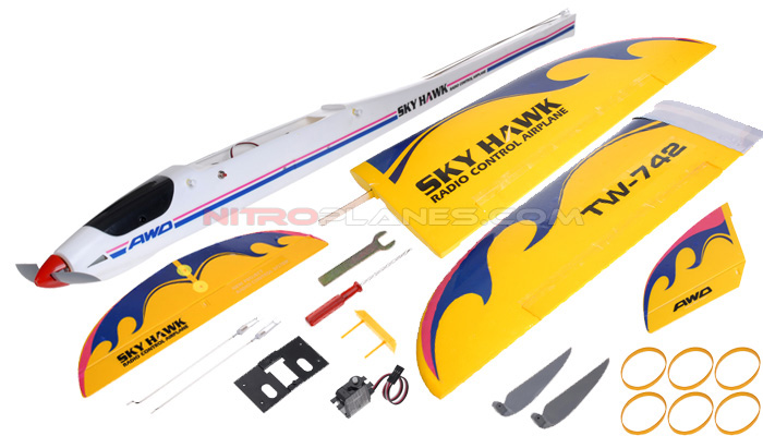

Those pushbuttons on the side of the plane. It seems obvious that they arm or enable the motor to start. My button came off (bad nut/thread assembly made the button push into the inside, plus AC glue does not stick to the fuselage material.), I fiddled with it, and now it's two solder coated bare leads. So, is the button "normally off", needing press and release for a momentary on? Or is it the other way around. Or is it normally off with a press to make it steadily On? I need to know so i can fly it with bare wires, and also so I can get the right replacement button.

Hi, and thank you for your suggestion. This is a Skyhawk http://www.raidentech.com/3skyharereco.html
The pushbutton is located right beside the sliding on-off switch. I disconnect the battery when I'm done, but I still turn the switch to off.
There is an ultra-micro pushbutton near the on-off switch, which rattled loose and then came apart. While I was fiddling with it, a wire came off of it, so I made two bare ends. CA glue won't stick to the slick body and wing plastic. I hope to find my Gorilla Glue to use for a try, and I'll use the foam cement to see if that works.

Hmmmm...I can imagine how a non-click momentary switch works. But you're right if the pushbutton were purposed to carry continuous current. Mine never clicked, but I had to press it to get the prop to respond to my radio. This might be a simple question, but i don't want to arrogantly overlook some purpose I can't figure out on my own. The sliding on-off switch is right beside the momentary pushbotton.

I have seen (and had) these push to arm ESCs on a few cheaper electric planes. It is to arm the motor after power up. I got tired of it on one, and just twisted the 2 wires together. The only downside was as soon as the plane comes on the motor can spin if the throttle is above idle, not a good idea for a plane with too much power.

Good, I can believe that explanation. Being such a beginner, I like the arm/disarm feature. It helps me do last-minute checks before I fly.
