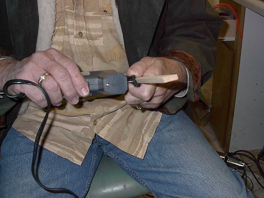

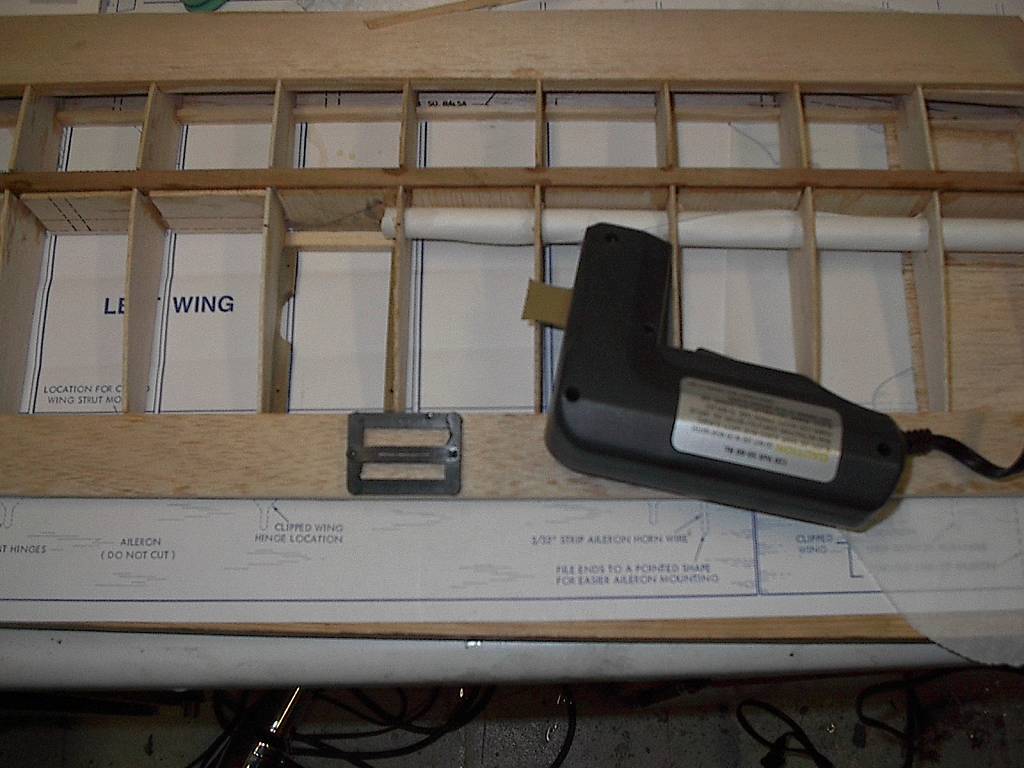

Default RE: Great Planes Slot Machine
My guide is black but what's in a color. It just folds onto the edge and is held in place then the blades of the machine is slid into the slot. Turn on the slot machine and have at it!! Most the time it's a nice straight slot. Can't get much easier then that. Well, hinge pins but that's another stroy!! I see our new2 and improoved servers are still having fun with us!!!!!!!!
