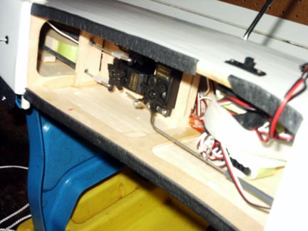

The build is going pretty well, although I must say I'm having some second thoughts about the positioning of the control rods. In my ARF, the servo tray came pre-installed, as did the motor mount. From where the throttle rod must be placed, the rod must make a significant bend downward into the bottom of the fuselage to meet up with where the servo tray is located. I was thinking about epoxying two .5 inch blocks onto the servo tray as it is installed to raise the throttle servo to a level where I won't have to make a bend. My main concern is to avoid friction in the operation of the throttle arm and while I'm fairly certain this will work, I'm surprised/dismayed at this apparent problem with the design and was wondering if anyone else had this problem.

It is not going to be a problem to put a bend in the throttle rod sufficient to make it to the servo arm. The throttle will have little or no stress in flight. What I found in building the two Avistar's I have is that it actually made it easier to put the battery and receiver on the tray in front of the servos.
By epoxying blocks in you may end up with unwanted weight and also taking away some of the useable room inside of the fuse.

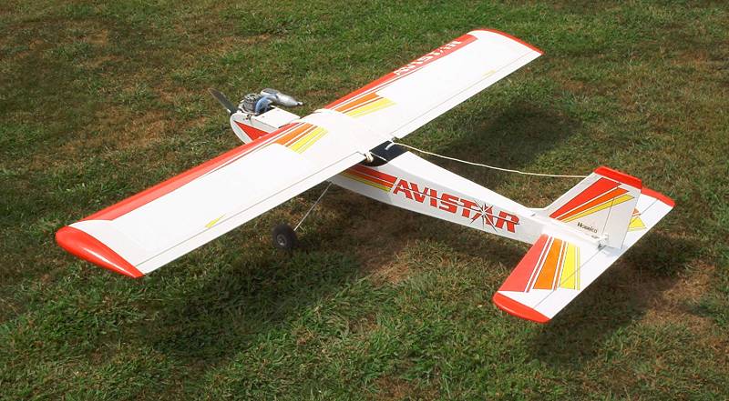

I got a busted up Avistar AWARF from e-bay and did some major mods out of necessity during the rebuild such as:
Swapped the 40 LA LA with an OS 46FX and an 11X5 APC prop = MAJOR power difference!!
Changing to sullivan glod metal clevis' along with 256 rods for the ailerons and 440 rods and clevis for the rudder and elevator
Tri-stock gussets on upper and lower rear horizontal stab and vertical wing
3 inch foam treaded wheels for the main gear and 3 inch rubber low bounce for nose gear for grass runway take offs
I re epoxied the firewall and all available exposed joints and expoxied the "seams" on the stock fuel tank to prevent inevitable leaks that I've heard thru RCU forums.
My Avistar took a months vacation since i bought a TT Lazy Tiger as my 3rd plane and 1st low wing tail dragger.
I took her out today cause it was way too gusty for the Lazy Tiger and WWWWWWWOOOOOW that's the last time this little spedd demon/ Monster will ever sit that long.
It really reminded me of how it is to fly FAST - even at 1/2 throttle you have to stay "right on her" constantly........everything happens SO quickly.
I was correct in thinking how she could handle the wind without much of a problem--------she SLICED thru the gusts with only very little twitching.
I still love this plane:
