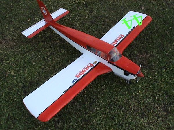

I am graduating to my first low wing after 6 months on a trainer. I have built a cherokee (great planes) 60" ARF. I have read that the flaps help the transition to a low wing on landings. I assume it slows the plane down some. could someone help with the proper use of the flaps. there are two stages of deployment. I have done all the reading the plane has to offer but would like some experianced advice before my first flight. any and all help is greatly appreciated!! thanks
RCU Forum Manager/Admin
I've got the same plane (reviewed it for RCU) and it really doesn't need the flaps. But they can be fun too!!!!! The best thing to use them for is making slower approaches on your landings. The best advice I can give you is to simply get up about 2 mistakes high and start making landing approaches and practice deploying the flaps so you get the feel for how the plane is going to respond. Once you start pulling the throttle back and the plane starts slowing is when you deploy them. If the plane is moving too fast when you use the flaps it will balloon up and climb. But keep the plane up high while you practice and you'll get the hang of using them. Once your are comfortable with how the plane responds with the flaps down then you can start trying them on a landing.

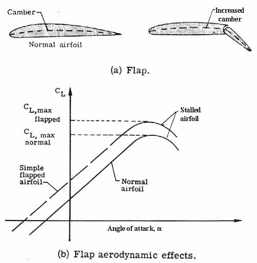

jaka, I must disagree with you and I do have 3 more years expierence than you
. Dropping the flaps increases the wing's camber thereby increasing lift and drag and decreasing speed without increasing the likehood of a tip stall. I have the same Cherokee and I like to use flaps if there is little or no head wind. It makes the plane even easier to land more smoothly than it normally is. I find with the Cherokee I need about 8% down elevator mixed in with with the flaps for a perfect landing configuration. I have three other planes (Pawnee, Trojan T-28, and an RV-4) that also have flaps and provide similar results. I also see no reason a beginner should not use flaps if it makes him feel more confortable with a given plane

To think that flaps increases lift and drag by increasing the wings camber is ignoring what is really causing the increase in lift and drag. When flaps are deployed the angle of attack goes up on that section of wing (usually the inward section) because lowering the trailing edge of the wing lowers the reference point where the cord line is measured. Because this section of wing has a higher angle of attack than the outward section it is the first to stall leaving the outward section still flying. And because this outward section has ailerons control is maintained. Just like you said it reduces tip stall. When you decide to land you don’t need extra lift but the ability to fly slow and still maintain control will come in handy.

I used the flaps(first time I've ever used them) on the maiden (of the GP Cherokee) because I have a short runway. I did a take off attempt without the flaps and found that the flaps were necessary for take off and landing For landing fly a few approaches without the flaps and see if they are needed.( For a 2 position switch) drop the the flaps on about half way down the downwind leg and use for landing.( For a 3 position switch) About half way down the downwind leg drop the first set of flaps and then when on just on final, drop the last of the flaps. Have an experience pilot beside ya and just relax. For landing fly a few approaches without the flaps and see if they are needed. I love using them, they make the landing look very cool. One more thing, take a video and pictures and post them.

cgibbo,
I would follow the manual directions very carefully and would practice all situations as described by Ken in post #2.
1) "Full flaps make the Cherokee .40 ARF very steady in the landing pattern, but just carry a little extra power to make up for the extra drag. The extra drag of the flaps also allows you to make shorter, steeper approaches.
2) The Cherokee .40 ARF needs to touch down with a nose high attitude to avoid whacking the nose gear and skipping back into the air. For this reason, landings with flaps require a deliberate flare with high rate elevator to raise the nose.
3) Touch and go’s and go-around’s can be accomplished with full flaps. Just use the elevator to establish a shallow climb.
4) It is preferred to have the flaps up or at “half†setting for takeoffs and climb-outs because the plane will accelerate and climb much better."

1) You are used to the rate of deceleration of your trainer when the power is reduced. The schematic shows that the section of the wings that is covered by the flaps will increase the lift force that is a produced for certain velocity and AOA (higher coefficient of lift or CL). Drag will increase as well, because drag is always associated to lift. For the second stage of the flaps (full deflection), the drag increases more than the lift, because the area facing the airstream increases much, and the flap acts more like an air break. The only force that opposes drag is thrust; hence, keep that engine pulling the plane, and avoid too low airspeed over the wing.
2) Flaps deflection may introduce a nose down (more frequently) or nose up pitch. The elevator is the only thing that can counteract that pitch and keep the plane in a horizontal or slightly nose up attitude (for landing). The elevator must have enough authority to do that compensation job. Flaps-elevator mix may be good to have. If no mix, then steady elevator input with deployed flaps may necessary.
3) When flaps are retracted, the wing loses the extra lift that had been gained after they were deployed. That may become dangerous if the airspeed is not increased accordingly and progressively and if the plane is too low.
4) Half setting = More lift than drag (Just what we want for any accelerating take-off).
