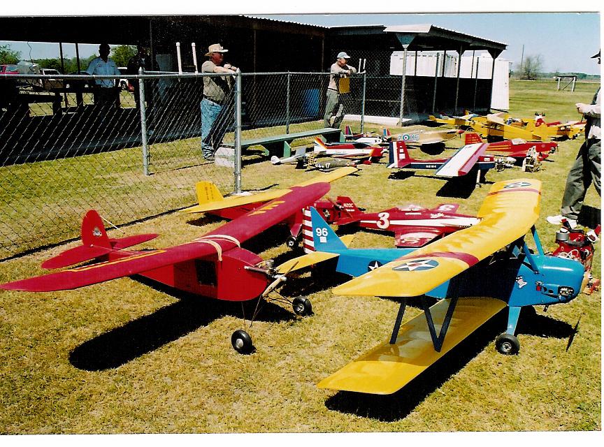

As an example in this picture taken 6-7 years ago that big red high-winge with much dihedral is a replica of the GUFF, Dr. Walt Good's original RC airplane first to be flown in the USA. It operates on 3 channel (Dr Good only had a rudder that was L or R or Center. ) A Como (Sup. Tigre) 60 hauls it off the ground in 15 ft. I do loops and rolls A-OK. Cruises well at half throttle. Thermals well. I think - without going out and measuring the chord - the wing is 1200 sq. inches +/- with a 96" span and it weighs 9#.
Hope this gives you some background info. for modeling performance.
