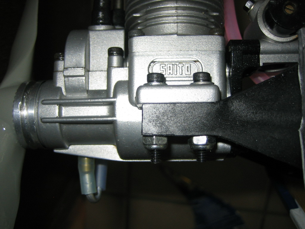

Acouple of pics to help visualize ...
Some mounts are flat on the top and bottom. SIGglass-filled mounts are used in pic 1. It's a Saito 82 four stroke. You can see that there is access to the bottom of the mount to add nyloc nuts.

pic 1 - 4-stroke, SIGmount, removable cowl
