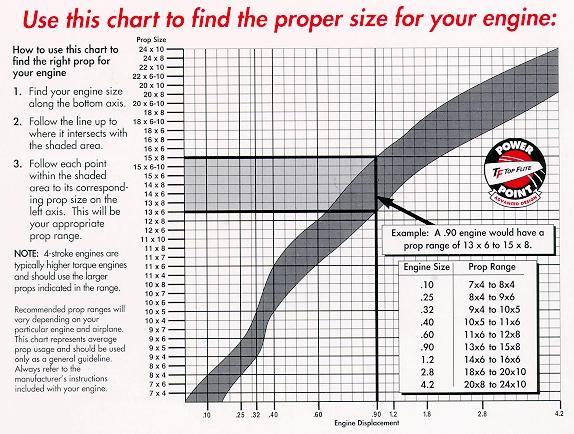

Here is a chart save it to your computer or print it out. Its a good place to start.
I highly recomend balancing and painting white tips on props.
TIP: You can use the paint to balance by applying a little more on the light side until balanced.
ALWAYS DEFLASH PLASTIC PROPS[8D]

I think that chart should be cleaned up and posted as a sticky. Then again it would kill about half the questions in a couple of forums!! It's not a bad chart and very easy to use. Testing is still required but it gives a good starting point.

i agree. it should be a sticky,  i just looked at the chart, and it is great for someone thats new like me. its easy to understand. no more questioning, ill get the recommended props and find out which one works for my plane. thanks so much for the chart!

You can look up the instructions and there will be several that are recommended by the engine manufacture. As long as the engine is kept in the working RPM that prop can be tested. It's a lot of choices. I have seen this chart before and it is something every new pilot should have on there shop wall. The chart is a ball park thing but that's where you start your testing anyway. There is no magic prop or size, one priop does not fit all. The chart is a great start. I'm going to print it out myself and give it to a number of people.

I just took the chart and posted it as it was as a sticky. I wasn't sure what needed to be "cleaned up" because it looked ok from my perspective. If there is something you want me to do with it, let me know and I'll do it.. OR, you can clean it up as you need to, and Email it to me. I'll PM you with my Email address.

ken, how about posting the prop chart as a sticky here in beginners?
