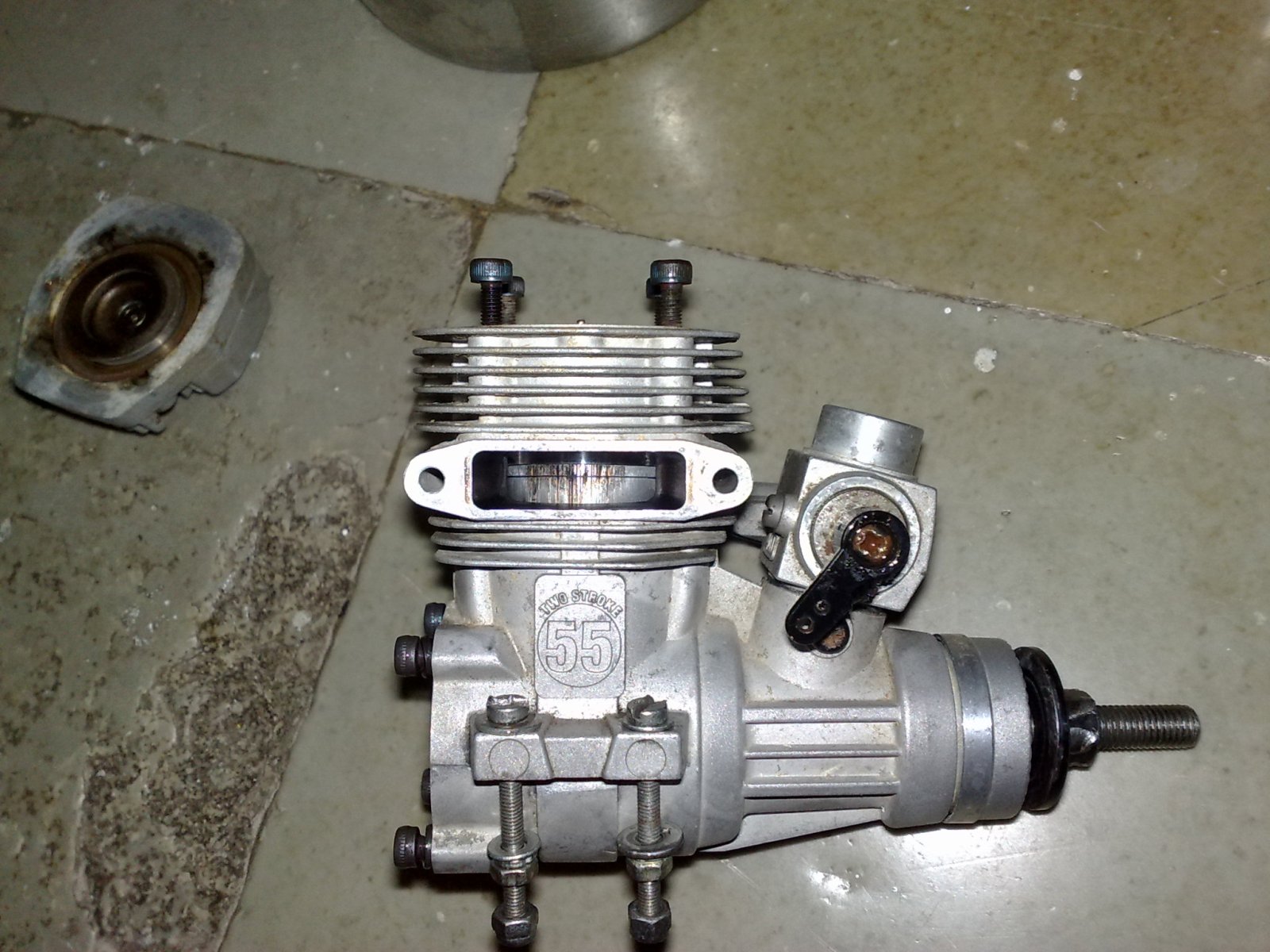

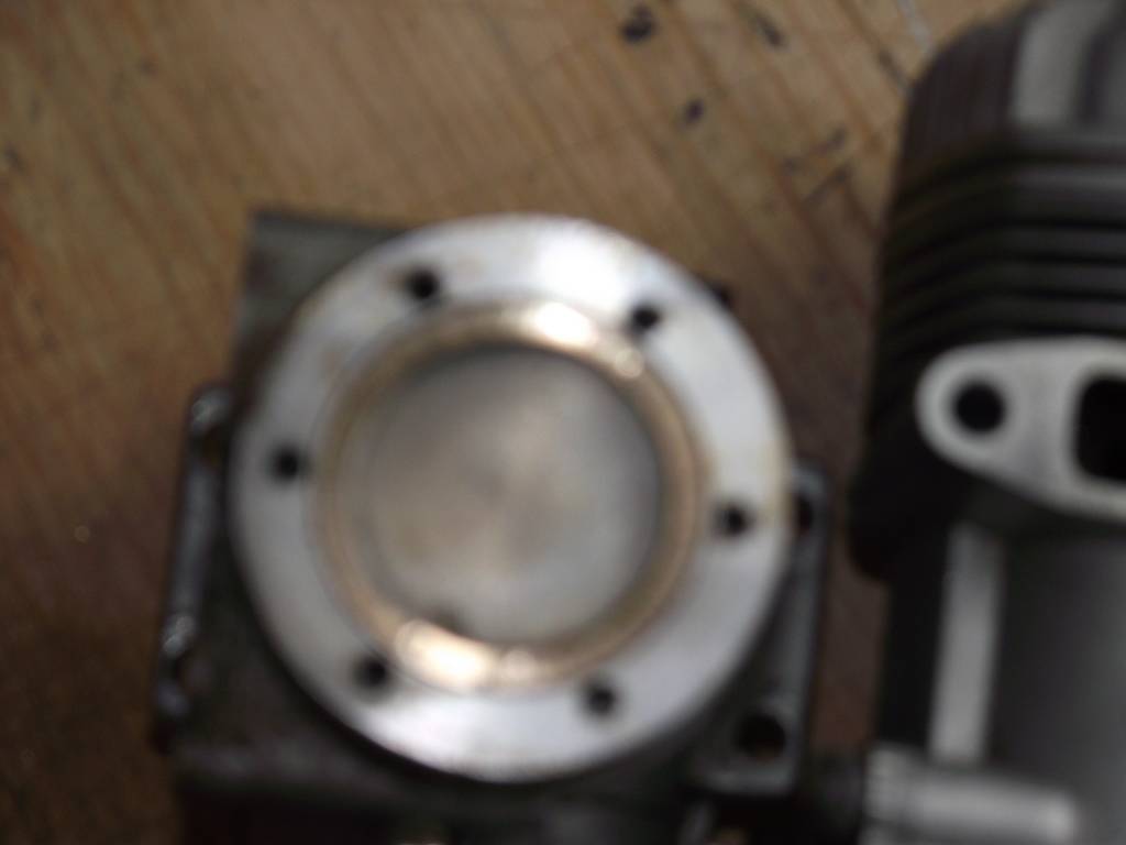

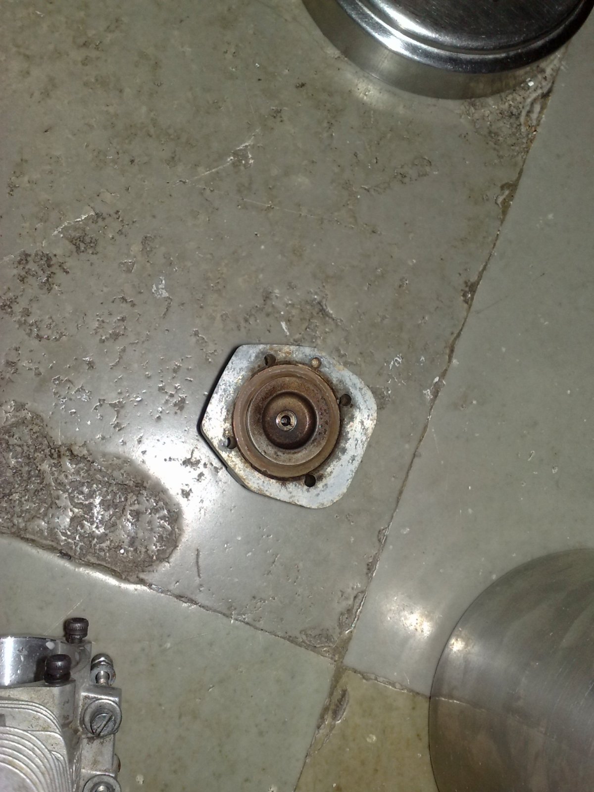

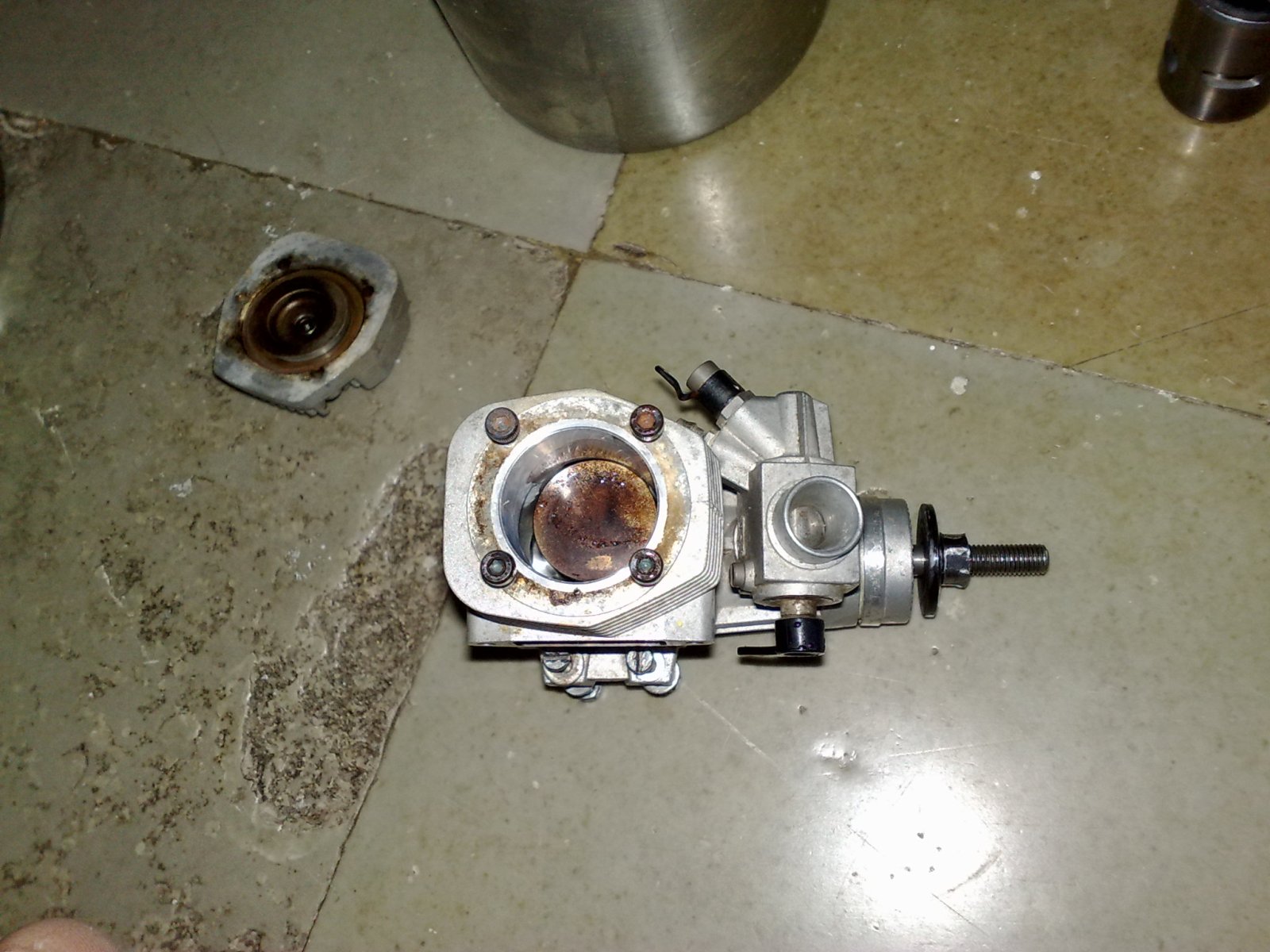

I have just washed (cleaned by dipping in plain alcohol for a couple of days) a very old 55ax. This specific engine has a scuffed piston but the liner seems to be OK. It was out of use for 4-5 months for the same reason. Have got some debris in the alcohol and a slight brown color. But the top of the piston has remained brown in color. The sides are all clear now. The bearings are slightly rusted but they seem to roll ok, no problems earlier with them either, just dead-stick after dead-stick even with this engine which could be due to other reasons. I stopped using it after it crashed a Reactor 46 but plan to use it now on a US40+ kit.
Now having washed the thing, I am going to re-assemble. Just wanted to know if the piston top color is natural or should I keep it immersed for a few more days. I have been mostly using plain castor on this engine with a bit of nitro

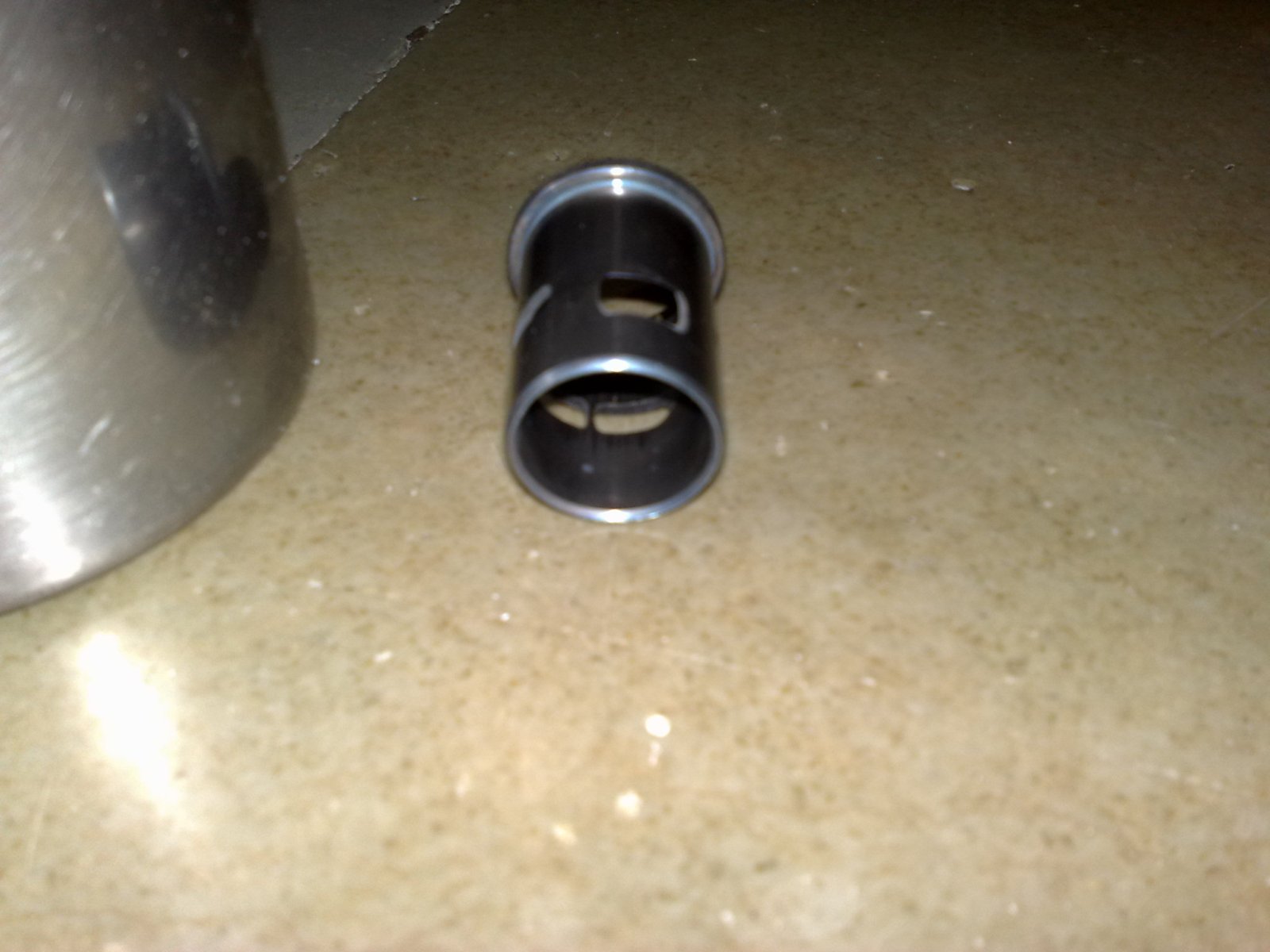

I am posting images of the top of the piston, side, head and liner. You can see the scuffing of the piston side very clearly, but trust me it is a lot less bad than it looks. On the liner also there is a bit . Dont think you can see in the pic and it is not seen very easily by eye either

Ameyam soaking in alcohol alone, without heat will not remove old color deposits but you are right the photos do look awful and of course with macro photos will tend to look like a sand paper consitancy on top of the piston, has it actully been eaten away? Also the sleeve is very difficult to see around the ports but is sure looks like its in poor shape agine its difficult with the pictures but it almost looks like peeling on the bottom edge of the ports.
The piston top and the head looks as though something has solid has banged around in the swish band area.

That just looks like some carbon build up on the piston and it cleans off fairly easily. I use a fingernail or bit of plastic to scrape off any lumps then scrub lightly with a used (softened) Scotchbrite pad. I've had pistons looking far worse than that one

Like I said, it is not that bad. You can see the scuff marks on the piston alright but not on the liner much unless you really look for them. This scuffing happened over a month of non-use at my instructor's place when I was not not flying after a crash. This engine was just sitting in his box of engines. But the engine still ran ok after that for about 3-4 months.
By the way, you cant see the exhaust porting in the photo of the pison side because the liner isint there. I removed the liner for inspection and didnt put it back yet. Will do that after thorough lubrication.

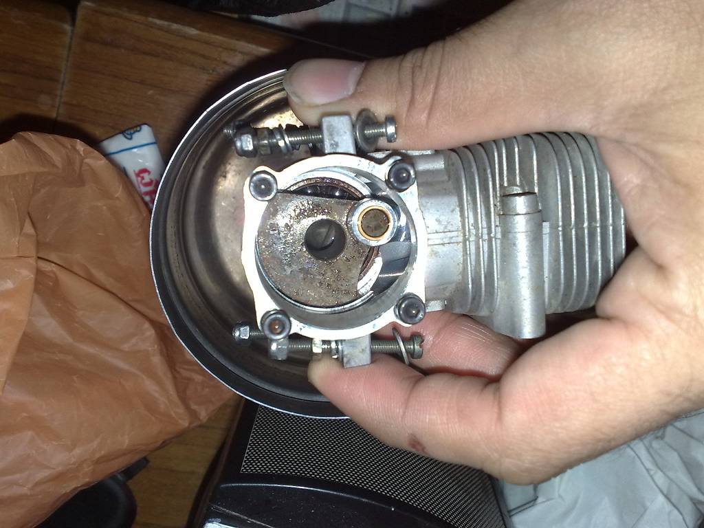

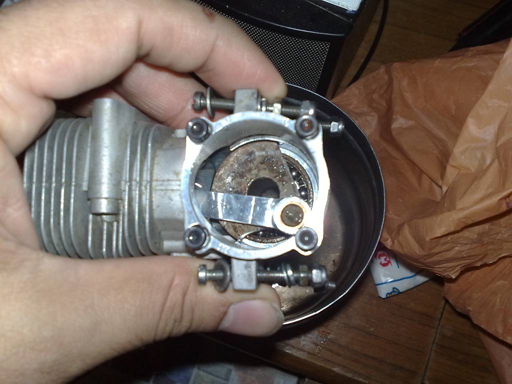

I am thinking I will run the engine regardless. I am including a pic of the bearings here. Didnt take them apart, just looking from the backplate side. Loaded them as from the camera. I couldnt get the o-rings off because the carb screws do not turn, the head is not engaging. So I dont want to use the crockpot/ boiling in soap water method if possible. If the clean-up is good enough, I will simply re-assemble and let the new synthetic fuel clean up the engine?

A lot of that brown patina is not rust. Burned castor oil looks a lot like rust, so if your bearings are turning smoothly then that's probably all it is. The carbon on your piston and on your head is not a problem. Use a paper towel with some ATF and it will get any actual accumulation off.

I dont have access to ATF so that isint a possibility. But I did keep it in for another day and then ran some used fine sandpaper over just to see. It does clean quite nicely. Just to ensure that I dont leave sandpaper grit in it, I have left it in for another day. Tomorrow, I will force air through the carb holes before I reassemble to ensure that there is no clogging. Then I will oil everything throroughly and re-assemble. Hopefully after that is done, it will be working decently enough to install on a US40 for Sunday. I plan to put one tank through the engine rich before I take to the air just to ensure everything is lubricated, any and all dirt is flushed and I dont have any deadsticks.
