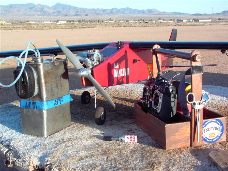

Required:
Glow ignitor. I use a hot shot type rechargeable.
Fuel and pump. I use a manual pump that velcro's to the side of the gallon fuel jug.
Chicken stick.
Extra wing attachments (either rubber bands or nylon bolts)
Windex and paper towels for cleanup.
Nice to have:
Electric starter. I use the starter with the battery attached to the bottom of it.
Extra glow plugs and glow plug wrench.
Extra prop and prop wrench. I use a 4 way prop/glow driver wrench.
Whatever screw/nut driver to remove/replace the spinner.
Volt meter to test how much power is left in the receiver battery. I use an expanded scale voltmeter.
Field charger. I have one. The only time I use it is if I am at the field all day long.
Things to leave at home:
CA and any other repair stuff. If it is damaged enough to need glue for repair, pack it up. Check it more thoroughly for damage at home. The only "repair" item I might have in my box is clear packing tape to cover a hole or lifting seam until I get home.
Of course this assumes that you are flying glow, not electric.

Joe, the tendency of the new guy is to buy every gadget the local hobby shop or tower shoves at them. But if you check what the experienced life long modeler brings to the flight line, you will find very little that is not needed, because we got tired of carrying the excess stuff around.
As John shows in his post, a simple fueling system with a manual pump - personally I like a good peristaltic pump that allows you to keep track of the amount of fuel you used on the previous flight by counting the number of crank turns.

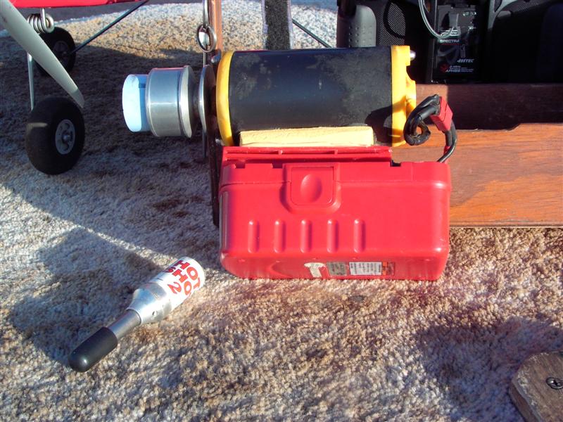

Then a glow plug system, there are many to chose from. Finally, a starter with the battery mounted to it like the one John showed. 18 Volts John, that will turn with some real enthusiasm. I built my first one almost 30 years ago with a couple nicad car packs, but there are also many commercial ones available today. Then make a simple small lightweight box or tray to hold the transmitter, starter, and plug driver so you can carry the airplane in one hand, and everything else in the other.

Whatever type box you decide on think real hard about going full portable and no power panel or big flight box battery.
I have set up many portable starters using many different types of batterys but votage is king. With just an inexpensive starter you can have the best performing starter at the field for cheap.
These are my latest setups a ten dollar 18volt battery, yes ten bucks on sale at Harbour Freight with just a block of balsa RTV,d (Silicon seal) to the battery and the starter the starter side is carved concave for the starter. Rock solid and a super starter.
John
