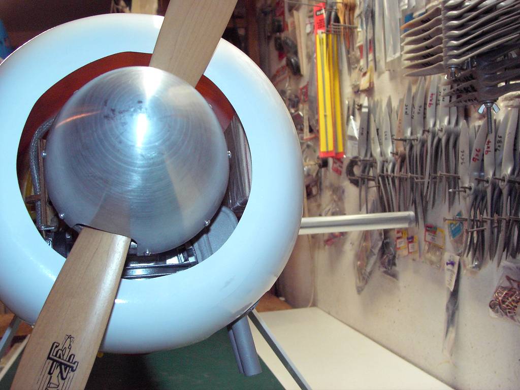

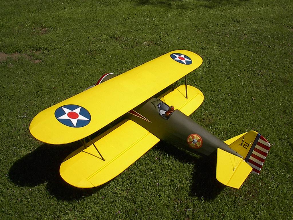

Boeing F4B-2, came in at 12 pounds complete. I used sub C 6 volt battery pack behind the fire wall, all controls as far forward as they would go. Required just over 3 pounds of lead in the cowl to CG correctly. So, it was now almost 16 pounds. I still have the plane, it did fly scale except it wouldn't loop without a dive. It is a slug and it's great trick is the stall turn, all it wants to do is fall out of the sky. Landing is really easy though. Take off and landing are really scale looking.
Any plane that had a radial engine was short coupled because of the engines weight so you will know before building it's going to be way tail heavy so you have to compensate during the build. I didn't!! I sent the plans to a friend and his came in at 12 pounds and is an outstanding plane in the air. Before the build I let him know the problems so he was able to think ahead.
How much lead?? As much as it takes. This plane is a 68 incher and you heard me groaning when I had to lift it. It's just a wall hanger these days unless I need something to fly at an IMAA event.

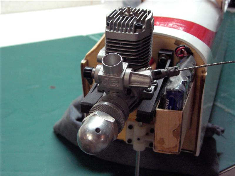

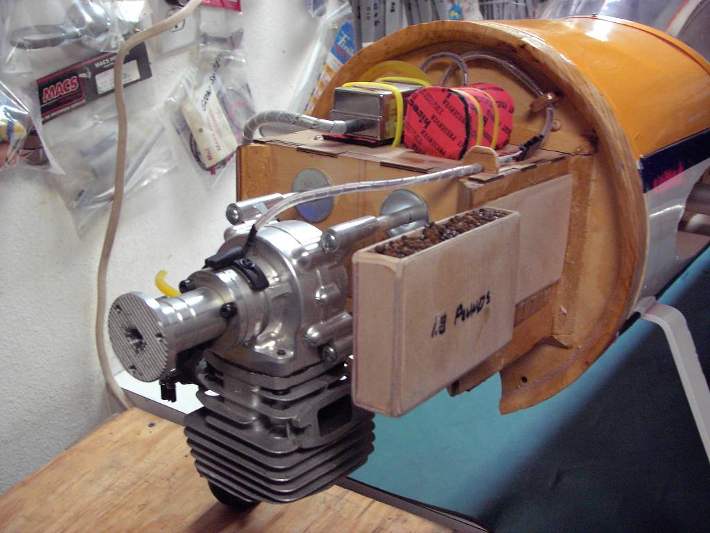

Two differents approachs, three different airplanes[8D]

John, I really like the battery box idea. Noet time I set up the old bipe I will give that a try. My pack was inside the plane mounted to the fire wall but that could be a big weight saver. Next engine I try in the Boeing will be an RCS 1.40 so I could set up the flight pack on one side and the ignition pack on the other. Thanks for the photos.

The battery box next to the engine is a novel approach. I am concerned that apparently you are not isolating the battery from vibration in the box. In the cantilevered box, next to the 2-stroke engine, vibration could be quite severe. I would feel safer with the box sized so as to allow wrapping the battery with foam. Then, one should protect the foam and battery from oil soaking.
The four cell battery weighs about four ounces. If you move it to its "normal" location behind the firewall, you would only have to add an ounce or two at the front of the firewall to compensate. All in all, with the increased risk for the battery, probably not worth doing for most applications.
I would also advise not mounting weights to a plastic or glass cowl in most cases. I have seen this cause cracks at the cowl mounting screws. It is safer to mount weights only to the firewall or possibly to the bottom of the engine mount. I have used long engine mount bolts on occasion, then mounted steel, iron, or lead weights to the bottom of the screws with another set of nuts. nc
I also no longer rely on stick-on weights (auto wheel weights.) The foam adhesive on these is NOT fuel proof in the long run, and these weights invariably fall out! My new favorite method is to cast my own lead weights in a small wooden mold, about 1 1/4 inch square x 1/2 inch high. This mold will produce a maximum weight of about 3.5 oz. I can stack these if needed, or cast a shallower one if less weight is needed. I drill one hole through the center of these lead coupons and hold in place with a 1/4-20 bolt through the firewall. You can tap the hole in the firewall or use a blind nut. Neat!
