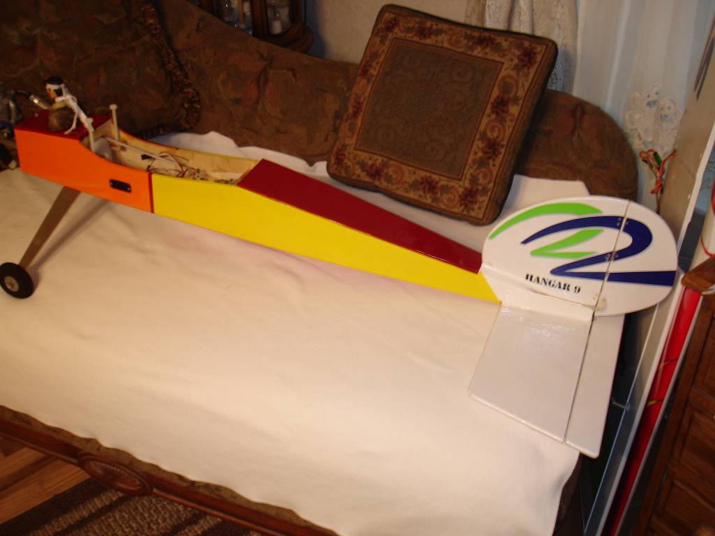

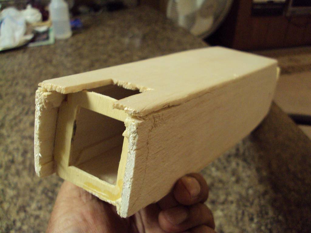

I have a 60 size hangar 9 super stick that has never been flown. It was purchased for my grandson. It has a magnum 91 4s on it. We took it to the field the other day and had it secured by the tail while he was doing his range check. When he throttle up the fuselage broke in two where the 4 slots for the pushrods exit. 2 slots on the top and 1 on each side all in the same area. The only thing holding the plane from taking off was the pushrods connected to the rudder and elevator. Contacted Horizon Hobby but no joy at this point. When I started examining the fuselage where it broke, the stringers going on the inside stopped at the slots. Grandson is sick over this. I talked with Horizon Hobby at the Toledo Show and both people that I talked with said it sounded like bad balsa. They did say that was probably not the way to secure the plane when starting it up, but that they do it themselves. I hope Horizon hobby will replace this for us.

That's a bad break, but it's not too hard to fix either. Truth be told, it wouldn't be much more work to glue up the break and recover than it would be to take everything out and rebuild the airplane.

John that is about what it looked like. That really is a weak point on that plane. The bottom of the stab butts up to the bottom sheeting on the fuselage. So with that, the 4 slots all in the same area makes it very weak.

I am rebuilding my 60 size ultra stick. Broke in the same spot. It has a lot of but joints there and it is a weak spot. Your not the first to have this problem to be sure.
There is a topic about mods to do on this plane if you do a search here on RCU. Basically reinforce firewall, landing gear, wing mounts and the wood between the elevator halves.

They told me that was not the preferred way to secure the plane but they knew that it was probably a general practice. They did not offer any suggestions as to the proper way to hold the plane. I normally use a flight stand and secure it by the wings. BTW, I did a repair on it and used a wing from an old ultra stick and the planes flies great. I have not flown the new super stick yet. I ended up putting a 75 ASP 2 stroke on it. Didn't have anymore spare 4 strokes not mounted. The repaired stick has a 91 4s Magnum. Here is a couple of pictures of the reworked Super Stick

You gotta love the relatively easy to fix nature of Stiks!
Last season I lawn darted my .60 Stik during a fun fly try to purposely crash into other planes on the field ( yes that was part of the contest ).
The fuse broke into four pieces. The wing mount sheared off at the wing root. The gear area ripped out, the firewall was smashed, the fuselage behind the wing broke and the tail came off completely looking much like yours.
I collected all of the pieces after the crash and stuck them in a box.
I was going to toss the plane, but instead I pulled the covering off and started glueing and re-inforcing.
A couple of hours of work later, the plane looks BETTER than new and is now much stronger than before with only a small weight penalty.
