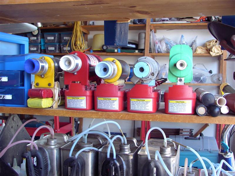

Hey lopflyers its never to late. If one flys a really wide variety of aircraft it some becomes obvious that one size really does not fit all. I use to use That green Sullivan Half A starter on two AAA seven cell packs 16.8 volts and this did help it graduate from .049 up to about .10 and even at 16.8 if was still pretty wimpy for anything more.
This thread got me going agine and since yesterday I added the 18v red battery and this thing now is easily going to handle up to .25. A size aircraft you come to appriciate more and more as one ages and one I have a lot of.
One may ask why a selection of starters but agine one appricates the lightest starter that does the job with gusto thats possible. Even with the red battery this green Sully is much easier to handel than say my mondo for the YS's.

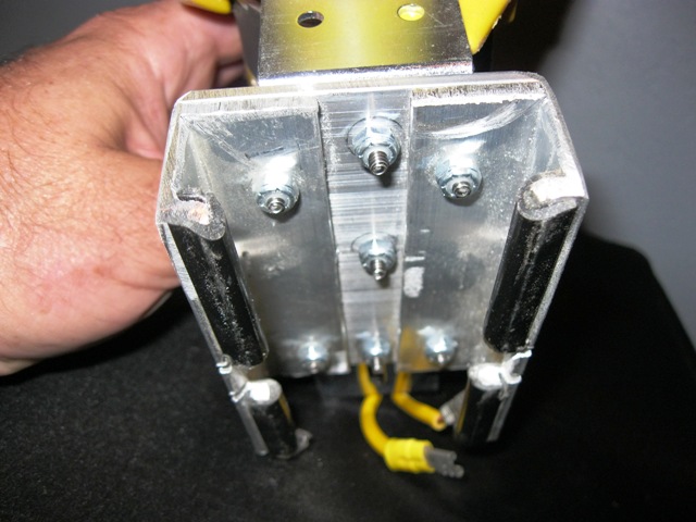

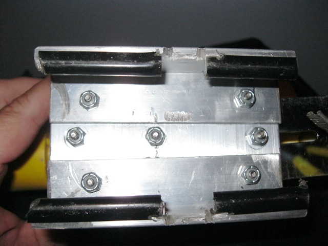

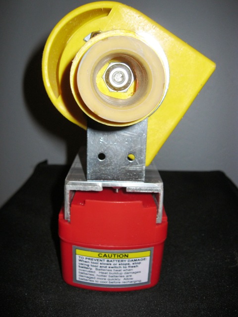

I have a Sullivan battery holder setup that I was never really happy with, so I adapted John's idea with the brackets already on the starter, some scrap auto door edge trim, 50 cents worth of scrap aluminum, and about five bucks worth of Lowe's stainless socket head screws...

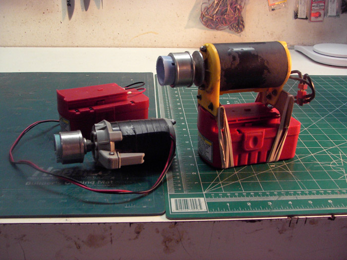

I used rubber bands and have the battery set up so the charge side is on the bottom so I can just slip the charger on when needed. Seems charging is needed pretty often, I charged it then used it the next day, put it in my box and a week later took it to the field again, it wouldn't roll over any engines. It's fully charged again but I have the ground lead removed from the battery to see if it will hold the charge while in storage longer.
