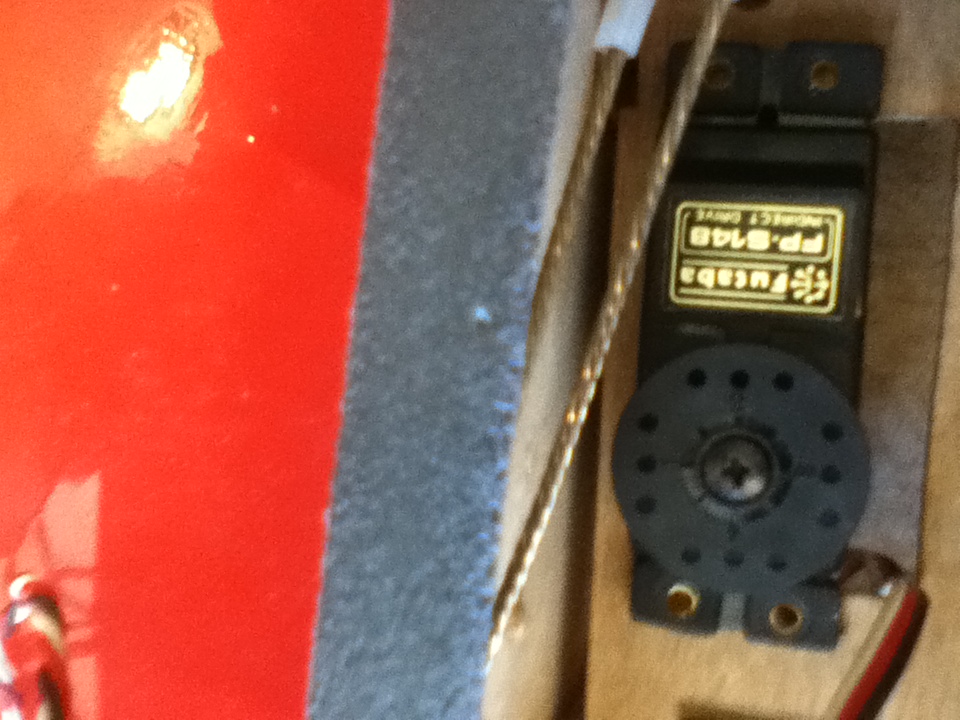

Ok first off, I'm a beginner flyer who has put about a week of "homework" into studying this hobby. My grandpop gave me this plane with all the stuff needed to put it together and fly it. This plane only has rear elevator, rudder, and throttle control so it needs only three servos. My grandpop had four, they came in a Futaba kit with servos, controller and, misc. pieces/parts.
Me and my brother decided today we would start putting it together. 1 minute after starting we realized we didn't know a lot about connecting servos. We tinkered with rc cars for a while but they had only one servo and the connection was screwed on. With the planes its off of a cable that is pushed in and out to adjust. We couldn't figure out how to hook these up and after two hours of searching im not having any luck.
I have posted pictures to kind of "explain" our current situation.

To use a cable type connection you need a connector that goes onto the servo arm and clamps onto the cable. Normally cables are only used for throttles though. They aren't stiff enough for the elevator or rudder in most planes.

My main suggestion is that you find where they fly in your area and find some help. What you have shown in pix can be easily understood simply by seeing how done in a plane. Also there is a great deal to be learned in achieving RC in a satisfactory and safe way so find help.Go to local hobby store as well.

Something like this is what you need:
http://www3.towerhobbies.com/cgi-bin...LXD929&P=0
It attaches to the servo arm then the cable passes through a hole and is held in place with a set screw.
You might want to find someone at your local RC club to help you out and/or check things over. You don't want to have the first flight end in a crash due to improper assembly or setup.

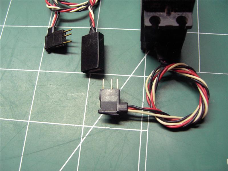

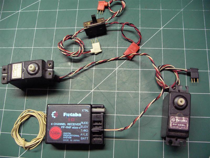

These are the long obsolete Futaba G plug. Note the center pin is positive like the later F plug, you can also see the unequal spacing of the pins therefore they are not compatiable. Its highly likely any Rx designed for the G plug unless its FM will also be wideband.
John
