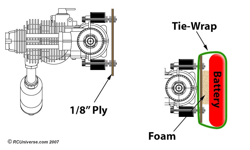

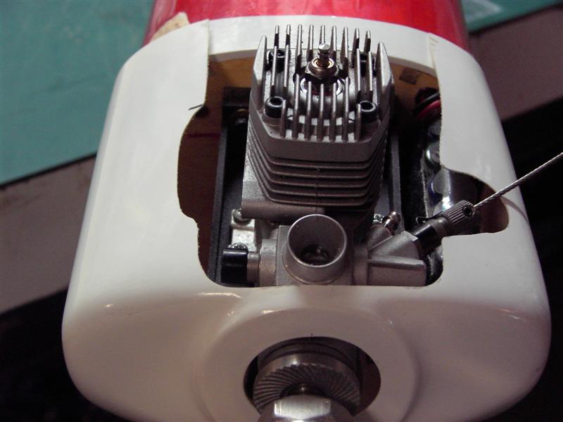

Old 05-02-2011 | 08:51 PM
JohnBuckner's Avatar
Posts: 10,441
Received 11 Likes on 11 Posts
From: Kingman, AZ
Default RE: ballancing
Battery runs cooler and there is no vibration problem.

Old 05-03-2011 | 04:47 AM
MinnFlyer's Avatar
Posts: 28,519
Received 9 Likes on 9 Posts
From: Willmar, MN
This is another way to do it.
