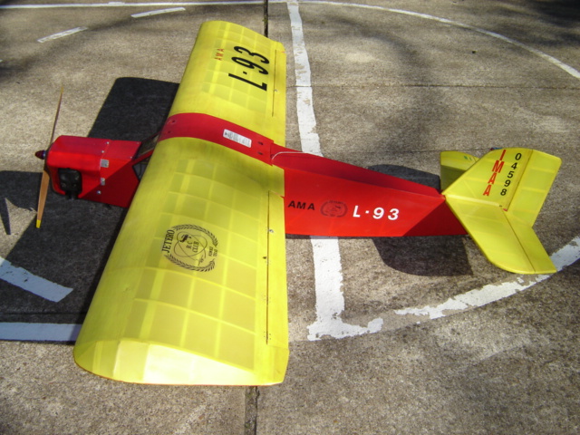

FYI here are some fabric machines. The monokote bipe is almost 15 years old but not flown in the past 6. Sorry I did that.
The fabric and painted models are definitely miles ahead of money-kote. The Eindecker is some 4 years old and is the Poly Fibre RC stuff, much lighter than the 1:1 scale material. In my learned opinion fabric is the only way to go. All the clear-coated machines are done with 5-6 coats of clear butyrate dope including the Eindecker. Keeps all very tight.
