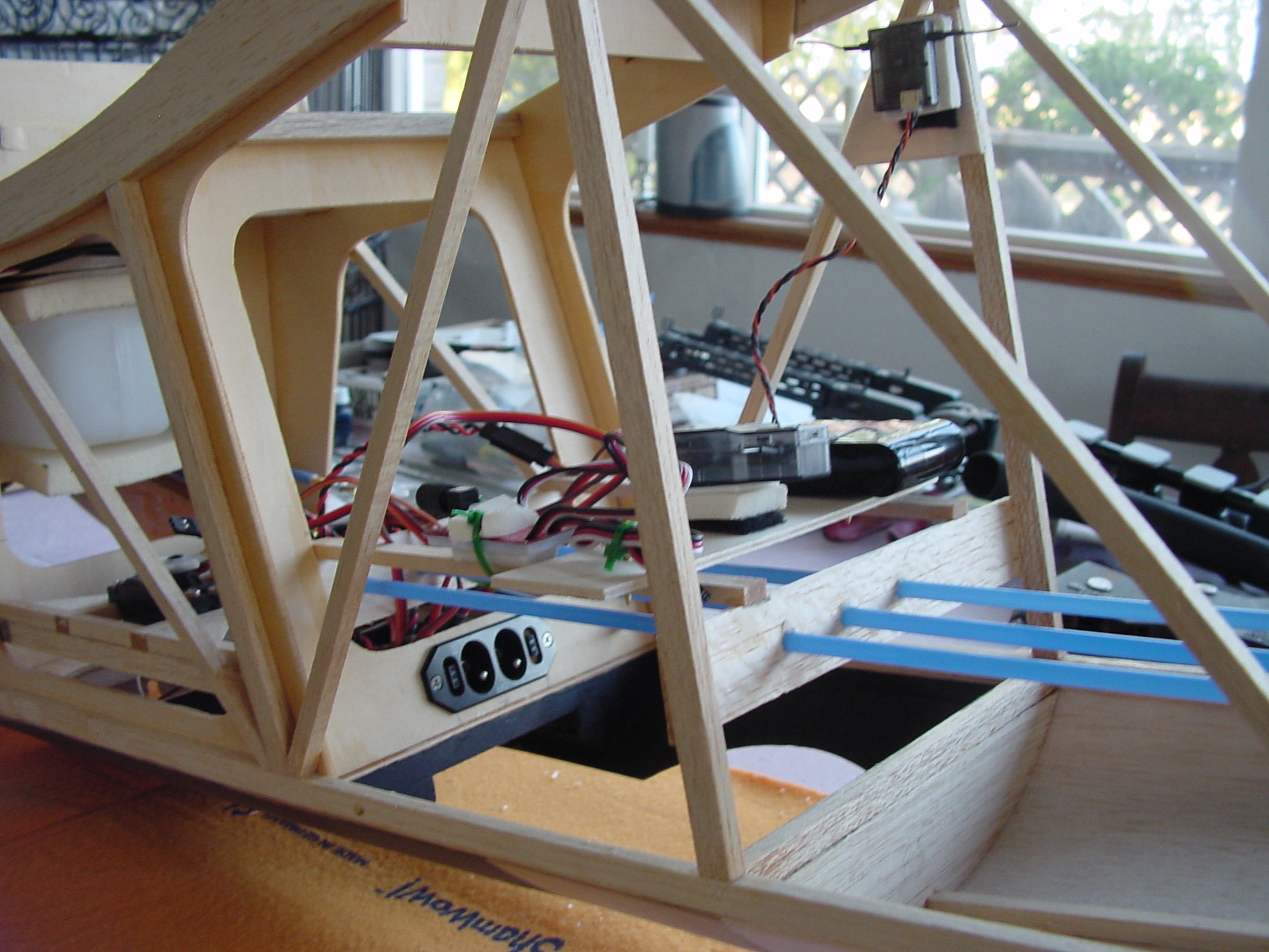

Is there some rule of thumb as to how close to the rx the rx battery can be? Best rx battery for the spectrum AR 7000 using six DS 821 servos? Plane is a 1/4 scale BUSA Fokker D-VII. Zenoah G-26 for power and an optical kill switch attached to the gear servo location. Will be installing a 2700mAh NiMH for the ignition module. Have the standard 4.8v,1100mAh NiCd that came with the receiver and a 6v 1400mAh NiCd. Any help for this nubbie appreciated. John

I usually use the Rx battery as ballast and put it in a convenient place that helps achieve the proper CG. If that happens to be right next to the RX, it isn't an issue at all.I would run 6 cells with that Spektrum receiver.

As Chuck said, placement of the battery in close proximity to the receiver isn't an issue. Heck, you can strap the receiver right on top of the battery if you need to and it won't cause any problems.

2700 MaH on the ignition??? Be sure that the igntion can handle six volts. The ones I have on my gassers are 5 cell 1500NiMh 4.8 volt NiMh for the ignition and 5 cell 2300 NiMh, six volt for the Rx. six volts will fry some ignitions, or at least it will fry the ones that I own.

 did you have a typo there??? You state that your ignition is 5 cell 4.8v. If the pack is 5 cell it's going to be 6v.

Bill, my 2700mAh is a 4.8 v. What I am now having problems with is the miracle switch I purchased. Each of the switches in the back have two wires and all my spectrum stuff is 3 wire. Wish I knew more about electronic stuff, this drives me nuts!!!!! No problem Grey Beard, think out loud all ya want to. I will use at least the 6v , 1400mAh for the rx and am thinking about the 6.6 v 2100 mAh LiFe packs from LiFeSource also.

The switch you purchased will work just fine for turning your Spektrum equipment on and off. For turning on the receiver only the positive and negative leads (black and red on your switch, red and brown on the Spektrum wiring) is used. However, if you need to bind the receiver the switch you have will not work. In order for that to work you will need a Spektrum 3 wire switch. But you can bind directly at the receiver if you need to.
