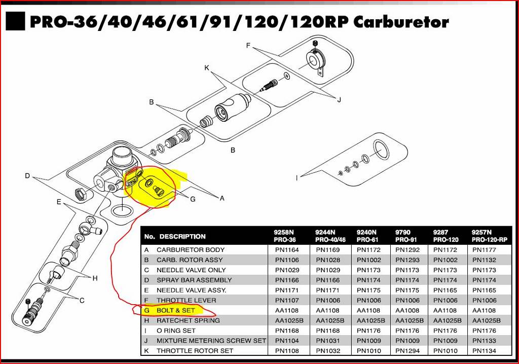

Hi - I have been flying Thunder Tiger Pro .46s with OS #3 or #8 glowplugs for several years. I always buy new engines and break them in myself as I have purchased used engines and never been able to get them to run well. The only problem I have experienced with Thunder Tiger engines is sometimes they will want to start running in reverse, but that is the exception and not the rule. I have tried to fly on old fuel and that will cause problems. I have not tried Merlin glow plugs so I cannot comment on that, but I've had nothing but good luck flying these engines.
You mentioned you did not know if your engine had a ring washer or not. That could be a big problem, as there is a ring washer that fits between the carburator and the engine. There is also a gasket that sits between the muffler and the engine housing as well. Hope these tips will help. Here is a URL for an exploded view of the engine http://mms.tiger.tw/upload/2008-1/20081265128.pdf.

fix-n-fly,
Thank you very much for such informative feed back as well as the exploded view of the engine. I did see the ring that goes between engine and carb, and I don't recall I had that one, that could be the problem as well. I wanted to try TT and never heard a bad thing about it, but I guess it was my luck. I'm gonna take some other measures to run it, I'm gonna clean out the fuel tank, take the carb off and do few other things. As far as old fuel is concerned, my fuel is few months old, once I had old old fuel but may be a year maximum and it completely got discolored, whatever the pink color or dye it had it completely dissipated and ran all the fuel through the motors, not a problem, and this fuel is pretty good, but I'm gonna try out the new fuel. Merlin plugs seem to be working good, and I read and heard good thing about 'em as they have long heads as compared to O.S. plugs. Mostly engines require hot plugs, but I'm gonna try medium in it. I'd keep y'all posted.

Loosing that bolt set does make a difference? as it runs through the throttle arm. If it's missing so what effect would it make on throttle arm?
I believe that bolt is used to guide the barrel in and out so that the idle needle valve blocks off the fuel flow so that there is not too much fuel for idle. When this screw is in place the barrel will move in and out when it rotates. It may run wide open, but will die or idle bad hen you chop the throttle. It is not common for this screw to fall out from vibration. Suggest a drop of lock tite when you install it.

Sport Pilot,
Thank you very much for your reply. You hit right in to the bulls eye. After loosing the stopper screw, I did not know I lost it and the plane won't idle well, it would die down even full-throttle was not stable, and I saw for the first time when I cleaned the carb that this screw runs between the throttle arm barrel and now I know the function of that screw. I've been advised to use green locktite for it, as blue would melt down, red would completely make it impossible to come off in case I'd ever need it and green is best.
My LHS did not have it, and they ordered the screw for me, and expected to be there this Friday. I'm gonna update y'all once I get the engine back to running as I've seen this engine with my own eyes screaming, hardly heard any grumbling about this engine, so why am I getting so much problems? I hope that's the last resort.
