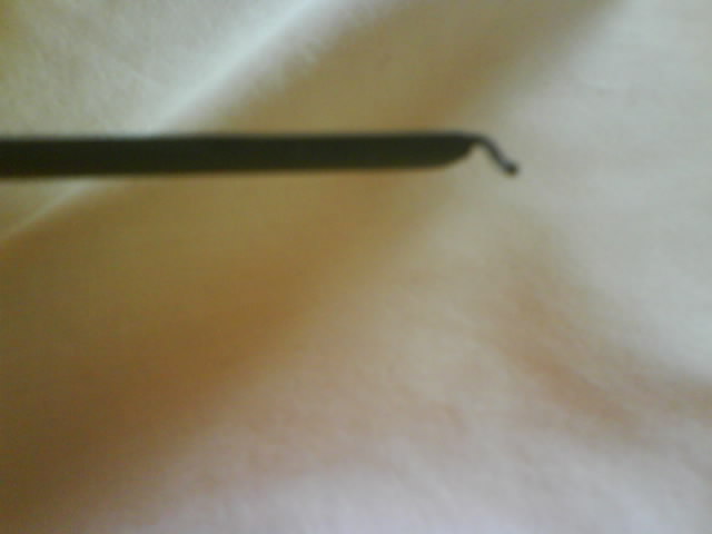

I am a compleate beginer and i have a sopwith pup prodject that imtrying to do while i find a trainer plane to learn to fly with
Just put some pics in the oringnalpost that i made up the top
Thas what i have to try and make but havent got a clue where to star t[&:]And sorry for the bad pictures.

I think, from your photos, you are trying to make what are called STRUTS. These are the (usually wooden) pieces which go between the wings of a biplane. Am I right?
If that is the case, you can use any soft wire (bike spoke would probably be OK) that you can bend to the shape you want.
There are two common types of wire found in hobby shops. This has previously been mentioned. They are called piano wire and I call the second type, pushrod wire. Piano wire is very hard and springy. It is hard to bend and tends to spring back to its original shape. It is used for things like undercarriages where strength and spring characteristics are needed. The push rod wire is much softer, easier to bend and does not spring back if you bend it too much. It is often threaded on one end so it can be fitted with a clevis which is the fitting you use to connect to an elevator or rudder or aileron horn (the horn is the (usually) plastic fitting which is on the movable surfaces so that the servo can make them move.)
A SPAR is usually the long structure inside a wing, usually at about the thickest part of the wing, which gives the wing its strength.
To make struts I would use the softer wire as you need to bend the ends so you can connect them to the wings. There are many ways of doing this. One plane I built (Cirrus Moth) used balsa struts which were made with a piece of soft wire sandwiched between two pieces of balsa. The ends of the wire had hooks on them which hooked into little loops which poked out of the top and bottom of the wing.
The struts on the Tiger Moth I have are made of harder wood and do not have any wire fittings but have flat metal fittings which hold them to the top and bottom wing. I could take some photos if you want.
I hope some of this makes some sense to you. I am sure people here will be pleased to help if they can.

You are not being a pain. You are just fine. You re-worded your post and now it makes more sense as to what you may looking for. It's just that at times, some of us just can't figure out what some folks are looking for when they write here.
But, I think you are looking for wires for the control rods that go from the servo to the control surface, or at least the ends of those rods. Is that correct? The "spar" is in the wing and is what gives it strength. It runs along the entire length of the wing from tip to tip.
Sometimes, those rods are made of wood and have a short length of wire on each end. One end goes to the servo and has an L or a Z bend on the end. That's a bend in the shape of an L or in the shape of a Z. On the other end, is one that has a wire that is threaded and has a "clevis" on the end of that. The clevis connects to one of the holes on the control horn on the control surface (rudder, elevator, aileron) and the rod threads on to that. It is threaded so you can easily make adjustments to the length to set it up properly.
Then again, Mike has another possible solution to your question... struts. Now that I look at the picture a bit better, it could be struts too. But, you have the benefit of both possible solutions.
CGr.

The photo looked like a cabane strut to me but between my fuzzy eyes and the fuzzy photo I wouldn't swear to it. I hate these lined trifocals. I used 2-56 control rod/wire for N-Struts on an Aeromaster so I could adjust the incidence, I did a nice job of soldering and getting them yo shape and size. They worked great until I would take plane up and really tear up the sky. When I would land there was always a broken wire. I would snap it clean off. Piano wire was better and didn't break but I had to borrow one of the dies to cut the correct threads for the clevises we use. They aren't a normal 2-56.

Piano wire must be the stuff as the other strut wire is hard to bend just noing what size i need to order now!
And have added more photos of the 1 strut on the plane so hopfullyyou can work it out more clearly.</p>

Balsa suppliers should have it in stock.
Often the hardwood is reinforced or backed by a wire strut as in your plane.
Check it out here: [link=https://www.balsausa.com/store/category.php?id_category=31]Click me for Strut wood.[/link]
Note the above is a HTTPS link so you'll have to answer NO to only show secure content....
Now you know. Fabricating this stuff is fairly easy. Two good pairs of pliers, one to hold the wire and one to bend it... and off you go.
