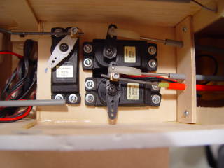

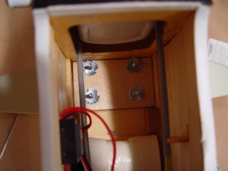

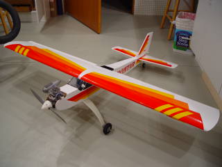

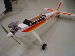

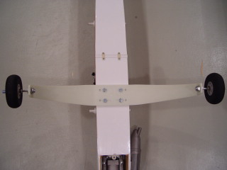

I did the same mod to my Avistar. Here's the pics - sorry for the small format.
Ichose to use a 2nd control rod from the rudder servo to control the tail wheel. A 1/4" piece of plywood LGbacking plate was insertedinside the fuse. Use tri-stock to reinforce the perimeter. In retrospect Iwould use 1/4x20 blind nuts with nylon bolts rather than the metal ones. Wasn't a problem as the plane died when used as a club trainer. The instructor on the buddy box wasn't quite fast enough to catch a screwup - my plane - my fault.
HTHto give you an idea.
