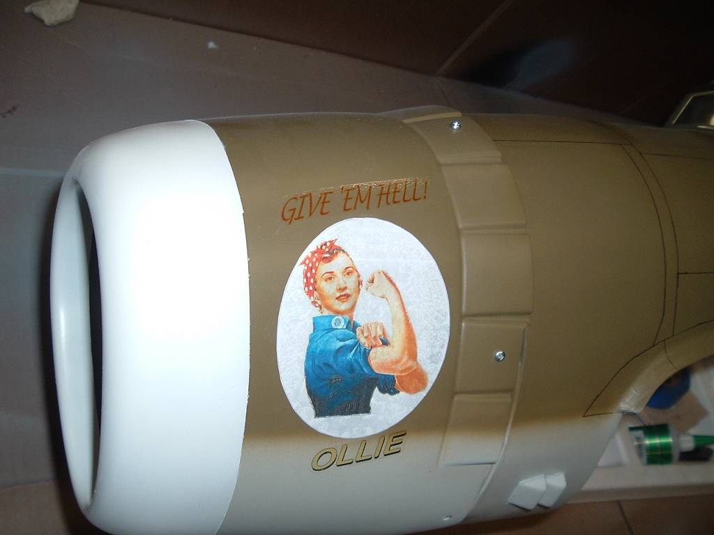

I got a small set from Testors, waterslide decal paper with the software to make stuff with. It comes with a little can of some spray, use it sparingly, as too much can cause the ink to run.
I did the graphic and text for this.
