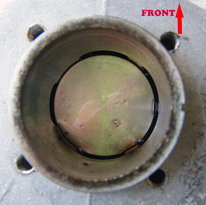

I have a ST 90 I took apart to clean and reassembled. I also installed a new ring. I am having problems with fuel leaking when breaking the engine in. I cannot tell exactly where it is coming from, however, it is not coming from where the engine and muffler meet. This leaves only two other places. Either the gap as shown in the photo or the back end of the engine where the 4 screws are. My guess is the gap. The following questions will help me in solving this issue:
1. Is the head oriented correctly?
2. Is 4cm the correct gap space between the head and the engine with the head properly installed?
3. Is the cylinder sleeve properly aligned? I think it is as the pix show.
Any other advice would be appreciated. Need to solve this.

I just looked at my G90 and the head gap looks the same. I can't tell how your sleeve is oriented, but if the exhaust lines up you're good. Are you getting raw fuel or oily burned residue leaking out?
One tip about Super Tigres if this is your first one is that they very often have loose bolts from the factory. I see you've had the head off so you should know if the head bolts were too loose, but the backplate is a common loose spot too. Check all of your bolts and clean the engine thoroughly. You should be able to tell very quickly from there on where any leak is coming from.

The head is oriented correctly with the slightly longer head finning to the rear (altgough it wouldn't really matter if it was 180 off). The liner is fitted correctly (there's obviously an alignment pin) but the liner would protrude above the crankcase by 4mm, not 4 cms, so you were correct the first time you showed the measurement
. The gap between the head and crankcase when the head is fitted is likely on the order of 2mm because the head fits down over the liner with the piston coming almost flush with the top of the liner at TDC.
If the head screws weren't tighten correctly then it's possible to warp the head and get leakage past the head shim. The screws should first be tightened until they just barely nip then tighten a small amount in several stages until they're nice and firm. With only 4 screws, tighten them as pairs 180 apart. You can check for leaks by using gas leak detector fluid or a weak solution of dishwashing liquid in the gap between the head and crankcase.
Fuel can sometimes spit back out of the carb and give the appearance that you have a leak somewhere.
. The gap between the head and crankcase when the head is fitted is likely on the order of 2mm because the head fits down over the liner with the piston coming almost flush with the top of the liner at TDC. If the head screws weren't tighten correctly then it's possible to warp the head and get leakage past the head shim. The screws should first be tightened until they just barely nip then tighten a small amount in several stages until they're nice and firm. With only 4 screws, tighten them as pairs 180 apart. You can check for leaks by using gas leak detector fluid or a weak solution of dishwashing liquid in the gap between the head and crankcase.

One area that the ST's have a tendancy of spitting fuel from, is the carb barrel.
ST's carb has a big and visible rubber seal to help keep this from happening, but it is not very effective.
The carb can leak fuel prior to start that gets blown back, making it appear the engine is leaking elsewhere.
Also remember that the bearings are designed to purposely allow the flow of oil past them, so most glow engines will seem to leak a bit of fuel.
This is most obvious if you store your planes nose down ( as I do ). I frequently see a drop ready to fall from the front engines of the planes I have in storage.
BTW: That shim looks a bit gritty in the photo. Did you clean it up before re-installing the head?

Problem solved. As usual something simple. Made new gasket for exhaust manifold. The leak made it look like it was coming from the head. Shudda dun this first!
