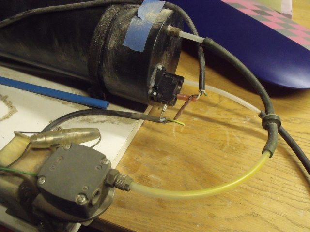

ORIGINAL: DMcQuinn
I like polyurethane wood glue. Gorilla glue is a brand name. Other manufacturers also sell this type of glue. It looks like maple syrup. Use plenty of weight. I like to get 3 or more pounds per square inch.
OK so on a 500 sq in wing you are stacking on 750 lbs per panel? The problem with using weight is that there is no way to get the weight evenly distributed. If you are going to build a few foam wings per year I would suggest building a vacuum bag system. In most cases you can find all the bits you need for under 100.00.
As for me. I use epoxy finishing resin. I find that Ican get a set of wings that are stronger, lighter, straiter then if I used poly glue. If you need to add glass or carbon cloth to key areas of the wing for added strength, epoxy is the only method.

To make a vacuum system you need:
Pump. Surplus stores have them cheap
Tank, I made one from 3" PVC and caps
Check Valve that goes between the pump and tank. Auto store item, emmissions part.
Vacuum switch, Aerospace Composites has these. It goes on the tank and switches off the pump when desired vacuum is reached.
Very simple to construct and once you get the hang of it, easier and faster then stacking weights.

Well Gray, you and Minn would be welcome in my workshop anytime. In fact the more I think about it, the more I realize that the odds are pretty good that I have crossed paths with one or both of you. In the early 90's I spent a couple years in the twin cities area. Flew at the 3M site, Alexandria and a place towards Shakopee. Used to buy from Maury at R/C City in St Paul and Hub Hobby Center in Little Canada. Up until about 4 years ago I was at every IMAC event at the North Vegas and Bennet fields.
Goirish asked for a pic of my vacuum system. Nothing fancy here but shows all the components and their location
