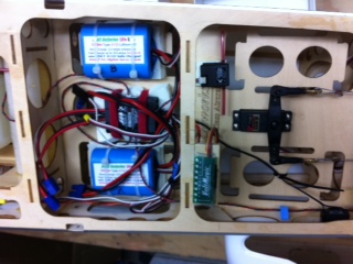

Speaking of that, I'll just share my dual battery setup that I learned here on the forum.
I used to have dual A123's into two switches with one voltmagic. The voltmagic would go into a low voltage reading after one flight (50cc Extra with DA50) on a fresh charge to both batteries. Come to find out...the switches and related extensions were just enough to cause a peak low voltage reading (momentary as it was).
So I switched to a Powersafe receiver and the soft switch. So two batteries with EC 3 connectors going directly into the receiver and the softswitch is tiny, tiny! The voltmagic is so sensitive I just watch those readings, count my flights and after 5 flights (I can probably go to 8 but dont) I pull the canopy and re-charge. I actually like pulling the canopy because it never hurts to take a look at connections and so forth every 5 flights of so anyway.
This set-up makes me most comfortable, is very reliable and I will be using something very similar on a Giant Aeromaster project soon.
With the voltmagic it is bullet proof!

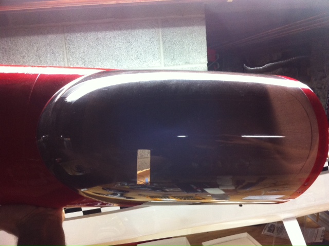

I mounted the voltmagic on a horizontal brace across the fuse and just below the canopy deck (50cc Extra 260 from Aeroworks). Then I cut a hole in the floor of the canopy to line up with where the Voltmagic is so I can see it through the bubble of the canopy. (Another tip I picked up here on RCU!). Plus the little LED lights look pretty cool when you power up.
Can't seem to get the phots uploaded at this point though....I'll try again later when I get some time. {oops...I see the photos AREthere}
