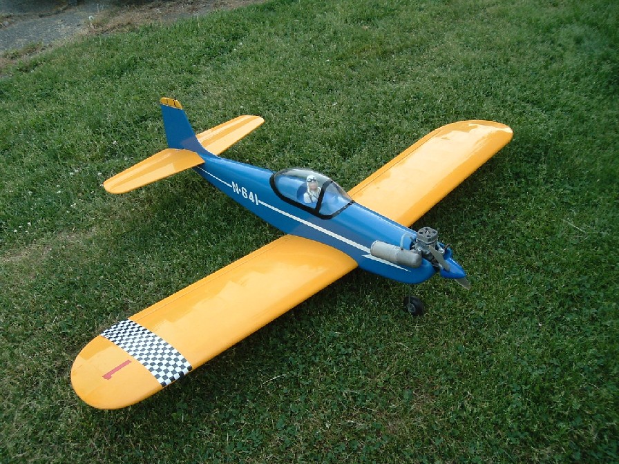

60 - 75 two stroke or 91 four stroke
mine using a Chipmunk canopy

bingo field's Avatar
Joined: May 2004
Posts: 1,732
From: Mt. Morris, NY
Default RE: sig astro hog engine?
Bigdan, I agree with you, if I had a spare 4 stroke, I would have it on this one. Why do you think the blond pilot is in a full canopy? It takes a whole can of Prell to fix her hair after a flight...
(see pics above)
