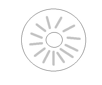

You are confusing the baffle and the muffler extension.
Virtually all mufflers have a disk or cone shaped baffle to help reduce the noise and to increase the back pressure. Removing this baffle can give you some increase in rpm, but may result in a slightly harder to tune engine. If you have considerable experience with engines, you shouldn't have any trouble.
The shiny extension is a different thing. Larger displacement engines need a muffler with a larger volume. Rather than make a new casting die, most manufacturers have taken to adding volume by adding an extension in the middle and using a longer center bolt. Your .52 muffler is more than likely exactly the same casting as a .46 muffler with the extension adding the needed volume for best power. You'll see some .75s and .91s using a .61 muffler casting with the extension.
If you use the OS muffler, or take the extension out of the ASP muffler, you may notice a small drop in rpm on the same prop.

There is NO funnel shaped baffle inside the ASP muffler.
Ihave tried finding a picture on the web of this baffle with no luck. I can take a picture of mine and post it if anyone is that interested in seeing it. I am attaching a crude drawing I just did of what it looks like (no, no artist and was done with MSPaint lol). The disc is flat...no funnel shape to it. its made into the extension. I cant remember if it is centered or closer to one end or the other. The grey lines are the slotted holes I speak of. The center is open to allow the bolt to pass through to hold both pieces together.
Also, I appologize to the OP for kind of hijacking this thread. I just wanted to say my tuning experience was similar to his and the only thing I had done to my engine was remove the baffle/extension.
