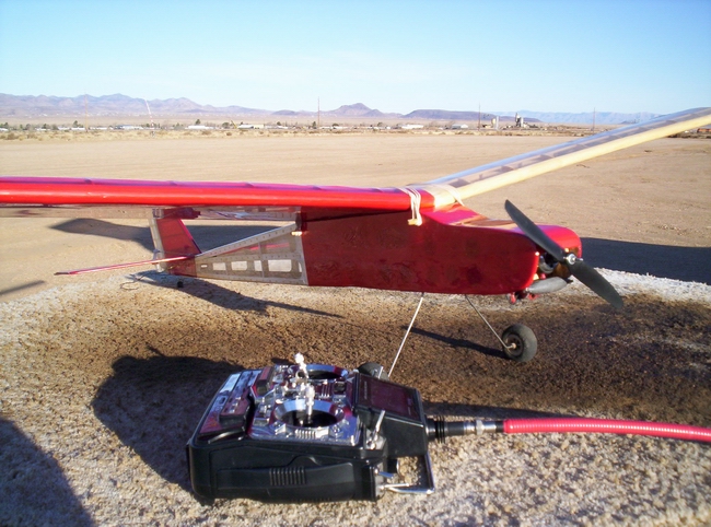

I disagree, build the wing as intended, It is what gives the airplane its delightful flying characteristics.
Yes the washout seems considerable but the very simple step to apply it during construction spelled out on the plans is easy and should not be left out unless you want just another OK but not so nice flying small trainer.
Here is my PT-E which is a slightly lightened version of the PT-20 which I built dunno maybe eighteen years ago as a first more or less modern electric. I still fly it a few times a year and its wonderful albeit with a much improved outrunner.
John
