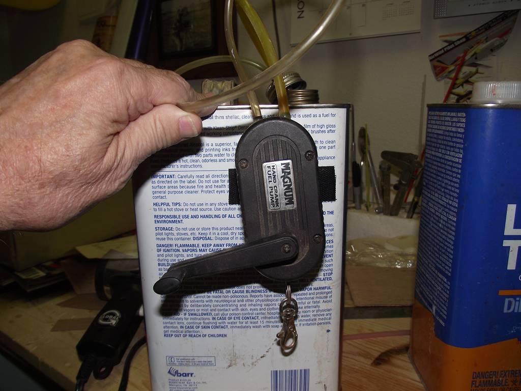

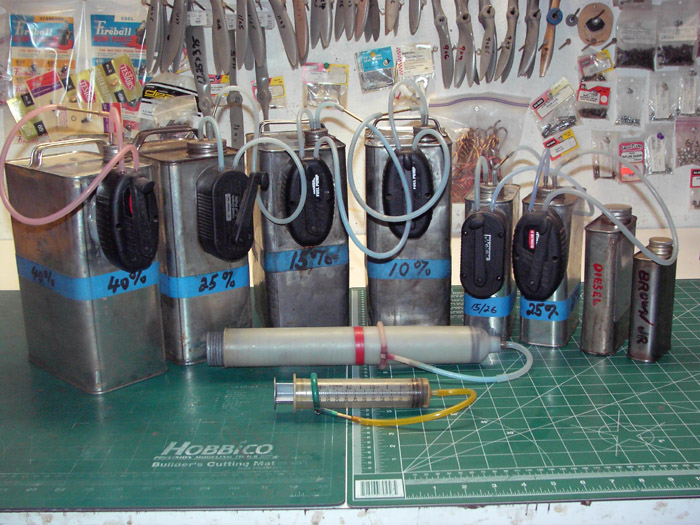

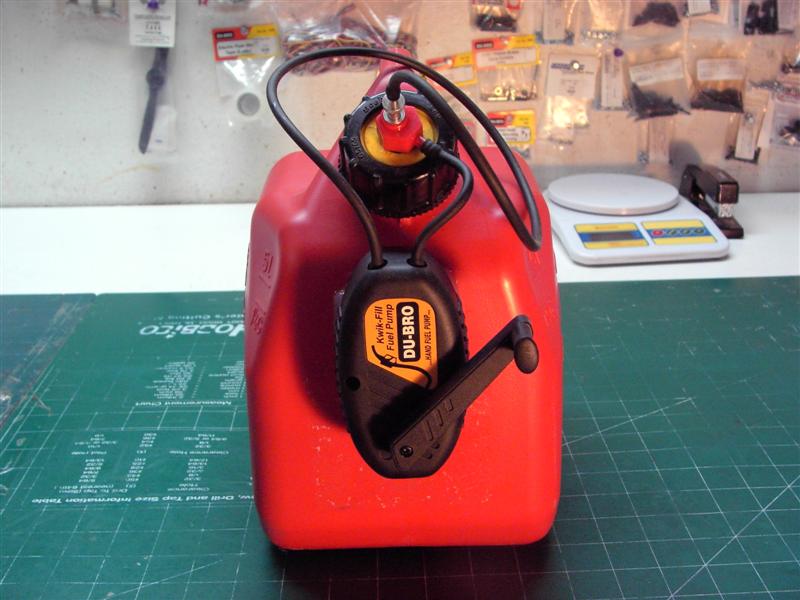

Sorry I have rejected electric pumps entirely. Here is what I use and the reason is not entirely reliabilty it is the lack of ability to count turns of fuel in and fuel out for consumption estimates.
The first picture is for glow and the small syringe with tygon is for vintage gassers and the small diesels. The next two pictures with the five litre gasolene container are for my big gassers, The neoprene hose is soon going to be replaced with tygon since the neoprene does not last much more than a season.
John

Because I never seem to have more then one or two gassers set up at any given time I sort of do the same thing as John. I just mix one gallon at a time so I use it up and mix up a fresh gallon in another can before I run out. I use one cheap Magnum hand pump for my gassers. Just transfer the pump and lid from can to can. Going electric is fine but unless I have several planes burning gas I wouldn't bother. This from a man that doesn't like hand pumping at all. I do use electric for my glow powered planes but I usually have two or three of them with me at the field and only one gasser.

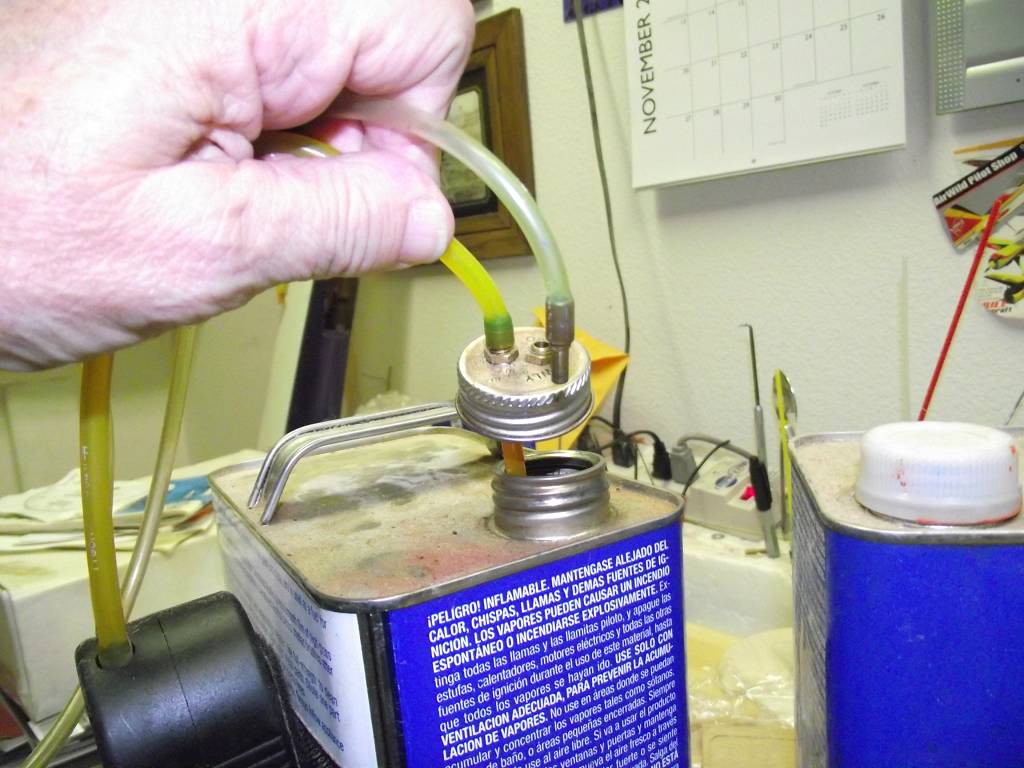

OK, it isn't worth over thinking. There is no difference inside of a glow pump there there is in a gas pump. You just need to use gas proof line like Tygon or even some of the clear lines you find in hardware stores. In my case I'm using both types. It's just a cheap glow fuel pump and been with me for years on my gas can. That's it. Just the line. I can either get the kit to turn a cans lid into a gas or fuel can or make my own lid. When I buy stuff like alcohol I make sure the cans I buy have the big lids so I have room to convert them. You can do the same thing with just copper or brass tube and solder. When one can is getting low on gas I take the other can and mix up a new gallon. When needed I just trade the caps/lids. If I'm going to the field I can remove the fuel cap nd install the other lid so it doesn't spill if it tips over. Free cans, home made lid/cap and a cheap Magnum glow fuel pump. There is nothing in the pump that the gas will attack and eat. Gas and glow pumps can be used first on glow fuel then the cap can be installed in a gas can, pumped out a crank or two then used. The one pump can be used for both types of fuel without problems. It's the neoprene fuel line that gas will attack and eat.

I have no idea if the other geared manual pumps will work for a long period of time without the impellor being affected or not But I beleve the Dubro is the only one that is specified for gasolene or glow fuels.
I cannot remember if that nice thru cap hardware was included with the Dubro pump or priced separately but it is Dubros hardware.
John

the dubro pump comes with these fittings http://www3.towerhobbies.com/cgi-bin...&I=LXRS88&P=ML

Yup thanks MJ thats what I put on my gasolene container in the pics. Just used it this morning.
