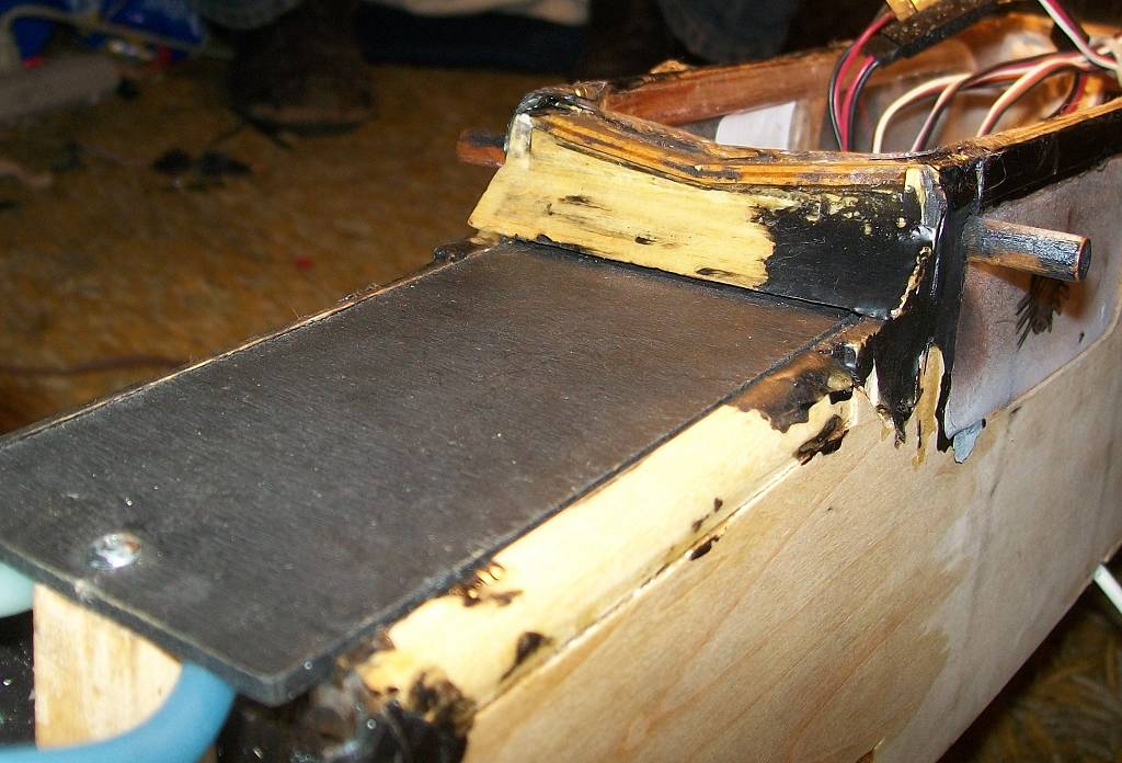

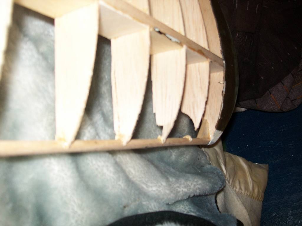

Ok well first off im new to Rc Airplanes and will be taking a flying course here soon.
Now i got ahold of a nitro traininer and the wing has a few breaks and dings. Now how would i go about fixing this?
Please send help
pictures attached!
Thanks<br type="_moz" />

It's obviously been repaired several times in the past. First, you need to determine if those prior repairs seem mechanically sound.
The missing chunks of rib can just have scrap balsa glued on the sides to fill in, then kinda match that scraps profile to one of the still good ones.
From the pics, the only repairs, other than recovering it, are the missing rib chunks.
The trashcan at the local flying field is usually a good source of scrap balsa to make repairs with. People are always stuffing their wrecked remains in the trash. Even the worst crashed ARF will have enough small bits of balsa to make the kind of repair this wing needs

Default RE: Repairing a Airplane wing
I agree with cutaway on the rib repair, add a servo ( second picture), nad before covering, remove all the covering and sand! Looks like it has been recovered at least three times. I dont believe the leading edge has ever been sheeted on this particular wing, the wood at the leading edge of the ribs would be thicker to accomodate the thickness of the sheeting. sounds like your doing the right thing by being trained, good luck with the repair!

Simple to fix those ribs.  First get some 3 by 5 card stock and put next to the good rib.  Carve off those gobs of glue on the LE and fit your car stock in, then trace the front of the rib.
Cut some 1/2 ribs out of the appropriate width of balsa.  Use these to replace the badly cracked or broken ribs.  I recommend sawing off the old rib about 1/2" out from the spar and gluing the replacement to this and the leading edge.
Voila,  Strong and light.  Looks fine.
Tom

Joined: Nov 2005
Posts: 12,624
From: Poolesville, MD
From the looks of things you're primarily looking at a recovering job.
That is not terribly difficult, but it may be something out of reach for a novice.
You have two choices IMHO...
1. - Find a local club and get a more experienced member to help you.
2. - Put the airframe aside, pull the components and put them into a new airframe.
Everything you have looks superficially OK, and a new airframe will set you back around $150.00.
If you are not experienced fixing this stuff, you can waste a lot of time and money learning ( not that this is a bad idea in the long run... ).
I approach it from a "am I better off fixing it, or working the hours it would take for me to buy a new airframe" view.
What is your take on that? That may guide your choice.

ORIGINAL: cutaway
honestly i don't see any repairs at all in those pics. it's well weathered but as long as the glue joints are solid it just needs a little sanding and recovering, the broke ribs are at the tip and truth be known can even be ignored on this airframe.
