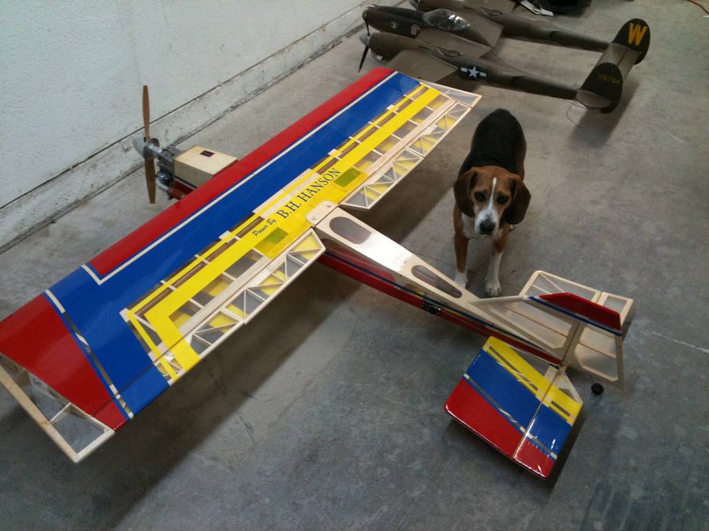

I liked the Sweet Stik so much I just found the plans with a template sheet on Ebay. I bought a copy and I plan on scratching out a new one. I may make two while I'm at it. There are no bad choices when it comes to stiks.

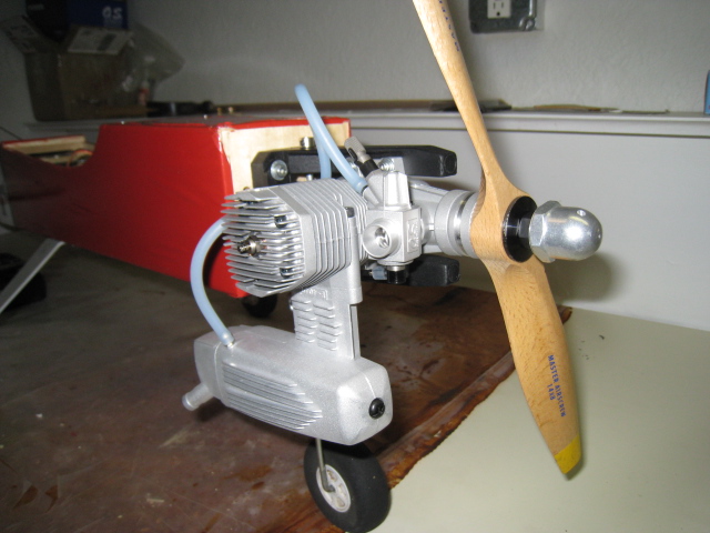

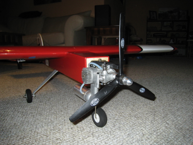

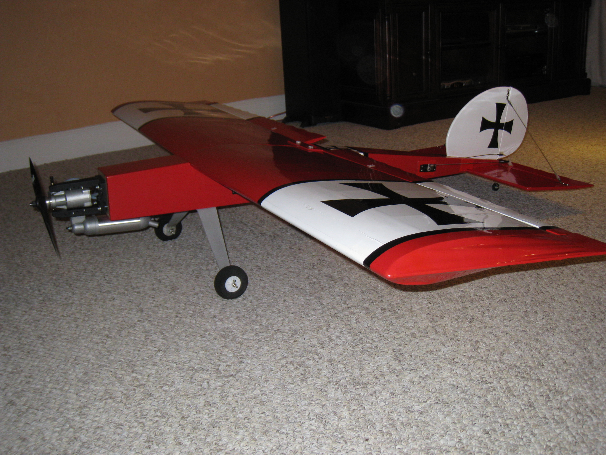

I'm just finishing up a GP Big Stik 60 with a ST 75 for power. Maybe not the best job of kit engineering, but not the worst either. Wood was somewhere between balsa and oak (honestly, some of the balsa wood was 18 lbs/cu. ft.). Yet it is going to come in at about 7 1/2 lbs when finished, giving a wing loading of about 19 oz/sq. ft. This will be my 4th or 5th stik since 1970, and I built it because I wanted a no bother, easy to maintain, cowl-less model for a change.
