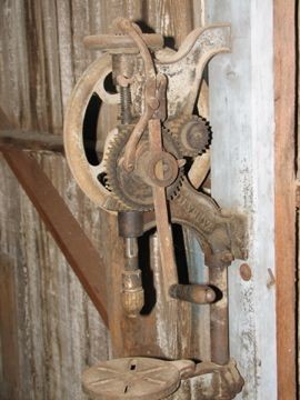

When looking into milling attachments for a drill press I found out that if the drill press spindle gets bent it will cut holes larger than the drill bit being used.
You may want to have a look at your drill press' spindle to see if the "wobble" came from it rather than the reamer.
When you say drill press we all think a nice new one but for all we know you could be using this one and there have been lots of opportunities for the spindle to get bent in the last 150 years.

Amish, Have you been scoping out my shop again (nice pic)
