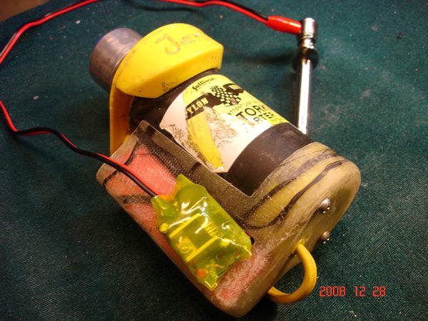

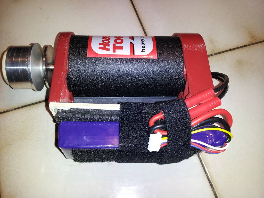

Hobbyking 3S1P 1800mAH, 20-30C discharge on Sullivan Dynatron. I start my DLE30cc engine about 10 times over the last weekend, and I used 10% of the batt according to the Cellmeter pro.
It spins the engine with ease.
3S works fine as long as the batt can provide sufficient current to the starter without voltage drop.

hey there, i just started experimenting with this last week and am very pleased with results. i hace 3s 4s and a 6s all on different starters. i think 4s on any 12v starter will give you plenty of starting power as it will easily spin my brand new Magnum 120 2-stroke and my buddies YS 170. i have a sullivan Dynatron laying around and strapped the 6s batt to it and HOLY-JESUS it'll just about start a Mac truck. Wayyyy toooo much but now i know. 3s should be fine for up to .60 size but i would recommend 4s 2000-3000mah and 20c is plenty.
just my opinion!!!

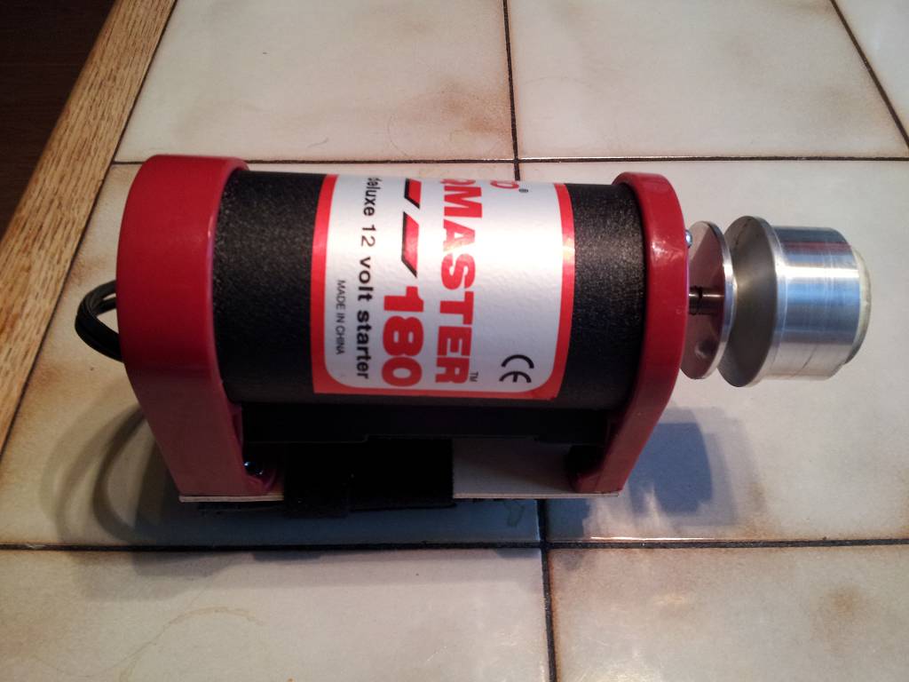

You guys got me thinking. I have five 28cc motors and my shoulder is not getting any younger! When one gets balkly my shoulder aches!
I have a cheap Hobbico Torquemaster 180 starter. After studying this thread I took it out of storage and tried it with a 5000 6 cell lipo. Oh my god was it wicked! I then scaled back to a Hobbyking 3000 4 cell nano tech. Worked great on my MLD28 engines. The photos are the finished product. A starter, small piece of plywood, 4 4/40 blind nuts, bolts, washers and cheap Hobbyking connectors.
Very light and very strong. Blew everything off the workbench when I tested it. Started the engine great even at 40 degrees!
Thanks guys.
Thanks guys.
