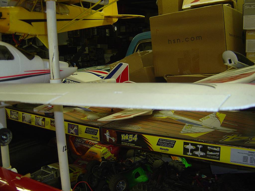

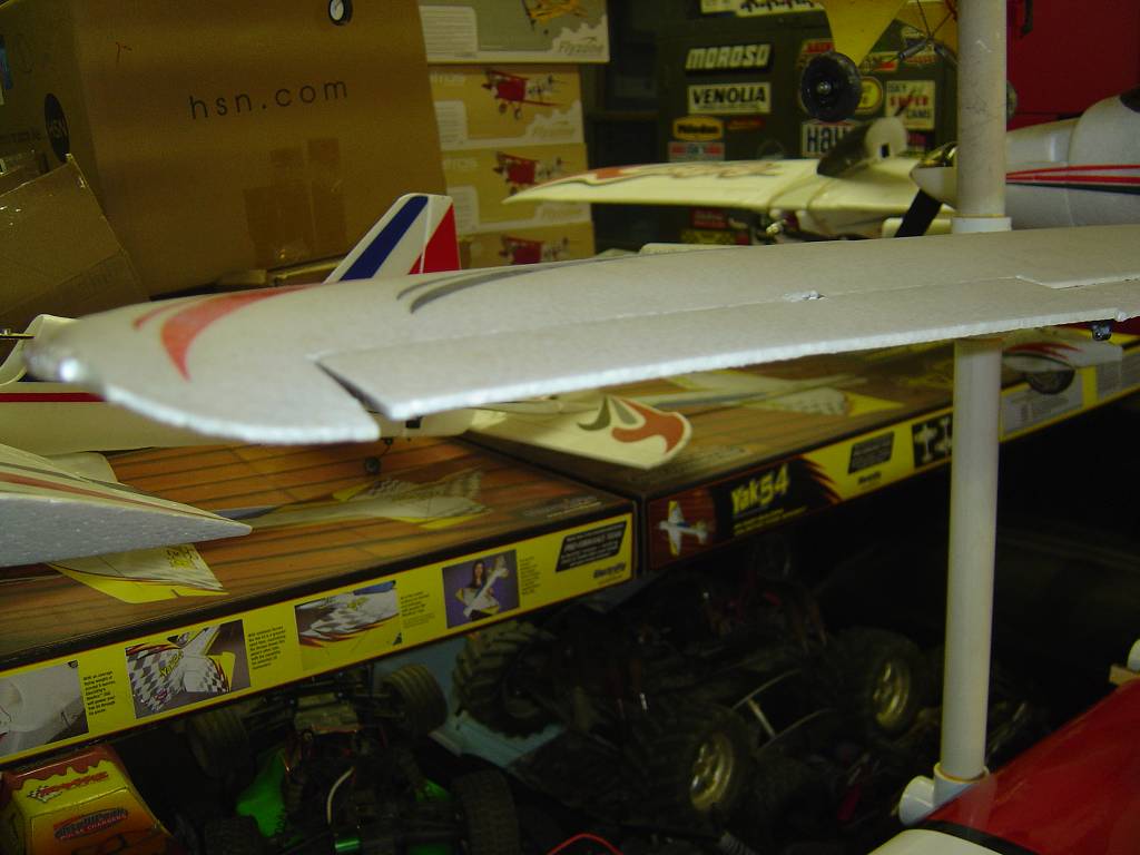

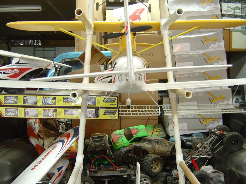

The back is twisted a lot as far as I'm concerned , but I don't know if it will be a big problem. I wouldn't know how to fix if I had to anyways. I just put this together and see that it is much worse than any of my other planes. I do have the skyfly max that the vertical fin is not even close to 90 degrees and it flies just fine (the elevator is level)
Here's a pic so you can see just how bad it is? How would I fix this anyways? How will it act in the air if I leave it? I'm guessing the whole rear is twisted 3 degrees or so and the wings seems level with the fuse.
BEFORE AND AFTER PICS

Hold the tail section, where the stabalizer and rudder join the fuselage at the rear, over a pot of boiling water and let the steam heat that area up real good. Then twist the fuse to get the surfaces lined up and hold it there til it cools.

After reading all of these good responses I was going to go ahead and fly it. This repair didn't sound too hard though so I tried it once without any results.
The second and third time I did it I was able to correct over half the problem. I think I was just not getting enough steam to it at first. Second time I allowed it to relax too much before a good cool. The third time did really nice. It not only had to twist , but had to be "steered" a bit too. It was a natural bend in that the more I twisted it the more it steered into place nicely. I might even do it again to get it perfect. I had the best luck with a water boiling pot with a 1/2" spout.
Patience (heating and cooling) was key in getting it to work and after doing it , it really is easy. A jig would be nice I suppose.
Thanks , guys for the help. Now if I crash it I can't blame it on the plane, right?

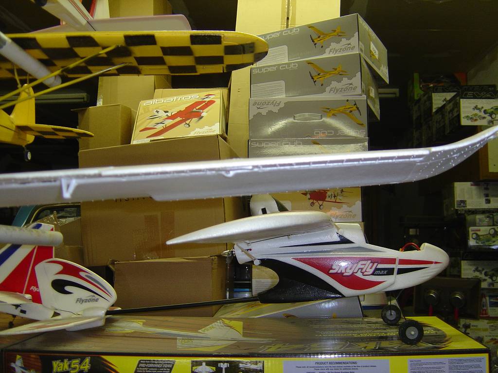

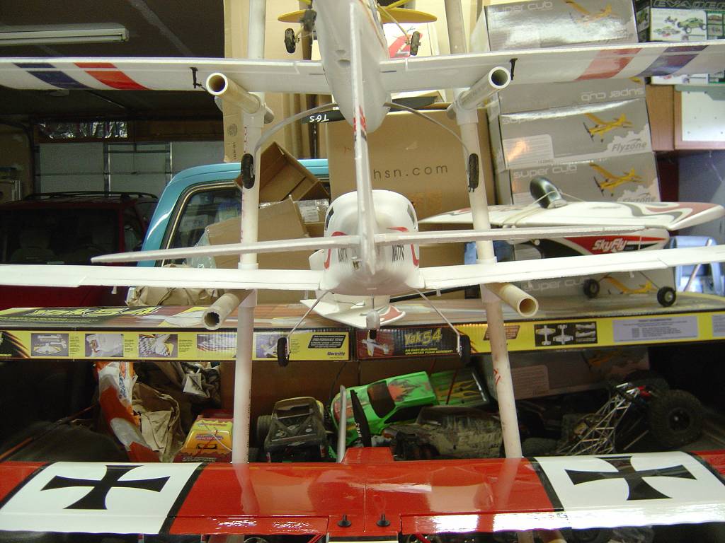

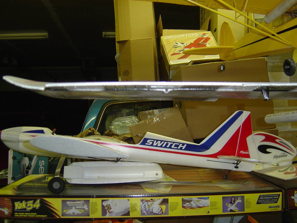

This turned out to be not so nice flying plane. It's probably not because of the twist necessarily. Here's how it trims out for staying level , but it continuously wants to roll to either/both sides. All The control surfaces aren't very strong and bend and warp easily. I seem to have a hard time with it because it is constant work (correcting) to make it fly. Flying inverted is pretty hard because it still wants to roll , but the worst thing I don't like is that when doing a roll the nose drops a bunch until inverted. Maybe a character of this rounded short fuse?
Yes, I'm complaining. [:'(] I will continue to fly it though and perhaps I will grow to like it soon. []
This is one that I'd take to the field and have someone else take it up and look it over. The flaps seem pretty level , but the ailerons are off quite a lot. Worst plane I have I think. Maybe I will check the lateral balance because I've never balanced any of mine before.
