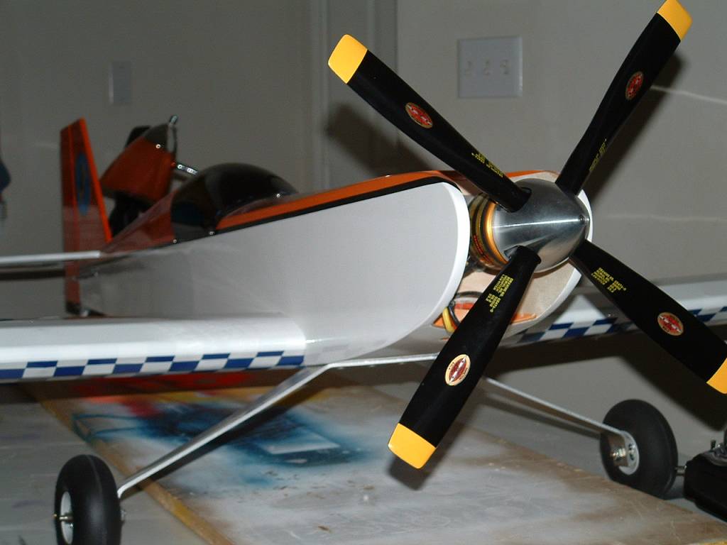

Default RE: How are you drilling your props
I have an AXI 5330/18 electric motor which is the equivalent of a 1.20 - 1.60 sized 4-stroke. It has a 12mm propellor shaft but the only reamer I had was for a smaller diameter than that. I don't have a drill press. So I went to my LHS and ordered one that would ream as large as 12mm. Can't remember what brand it was but it worked great. Reamed a brand new 16x8 Biella prop with it. Put it on my 4* 120 just to see what it would look like.

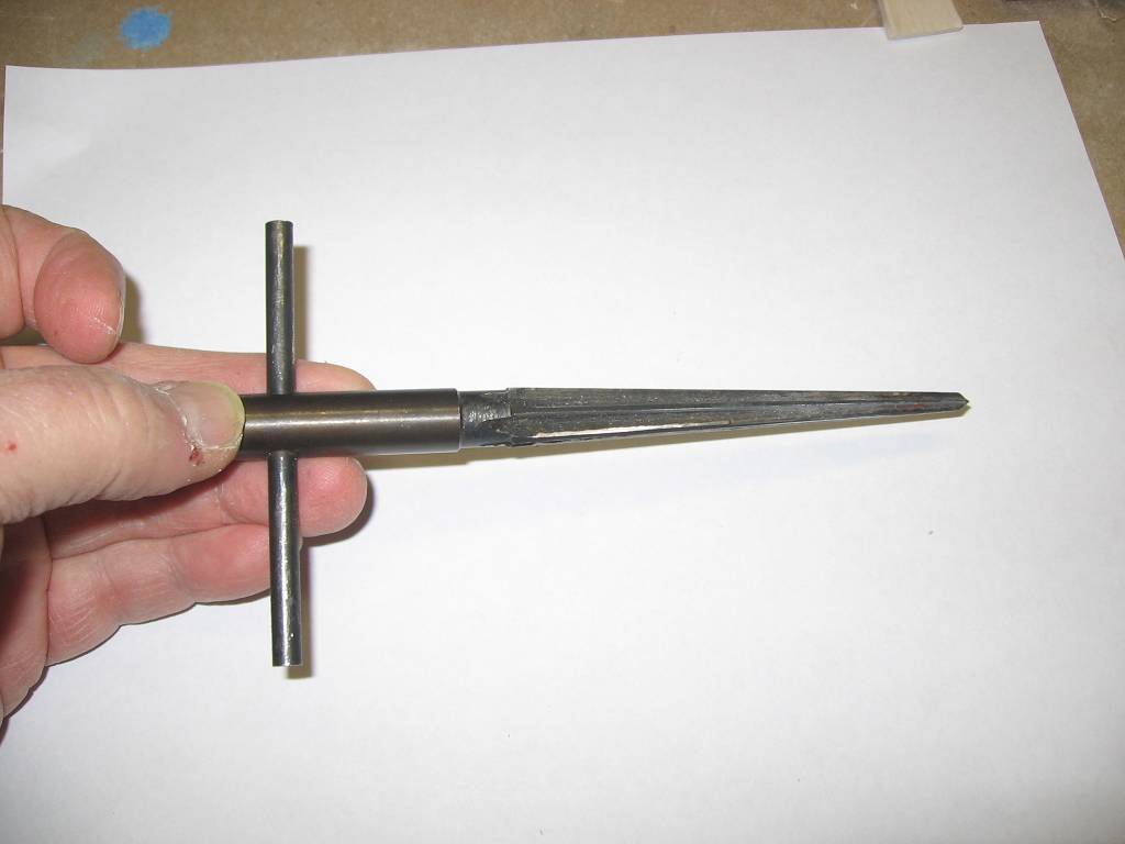

Get a tapered reamer and you will throw all your step reamers in the trash. According to APC Props recommendations you should be using a tapered reamer anyway. Here is a link to thier site help page explaining why. Also a pic of the one I use. It goes to 12.7 mm.
Read the section that says "Engine shaft hole alighnment"
http://www.apcprop.com/v/html/tech_s...html#holealign
By the way. With a tapered reamer you don't need a SAE and metric. It does all sizes with one tool.
