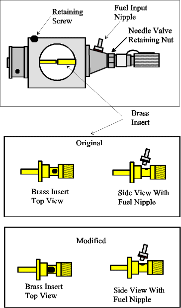

Many Chinese engines have trouble running good even when brand new.....this fellow named Wayne Miller had 2 GMS .47 2 stroke engines....one was running good and the other would quit on Wide Open Throttle.....well after putting a baffle inside the muffler he got it to run good.........However, he was not satisfied as the engine should run good without the extra muffler restriction brought about by the baffle inside the muffler..............So he took away the baffle and then.........he decided to take a look inside the carburetor fuel inlet nipple........inside he could see the brass insert with the fuel hole that should be lined up with the fuel inlet nipple........Lo and behold!!!!!! the fuel hole of the brass insert is misaligned with the hole in the fuel inlet nipple. So the fuel at Wide Open Throttle was restricted from going straight into the spray bar inlet hole and was cutting off the engine at Wide Open Throttle. So he removed the fuel inlet nipple and drilled it one drill bit size larger and also drilled the inlet hole of the brass tube so that both fuel holes line up. I copied the drawing that Wayne Miller made so that the problem and the solution could be better understood. Larry.

I copied Wayne Miller's solution in here along with his drawing I posted previously at the above post and I attached also the picture taken by FlyboyDave of the misaligned fuel holes with the fuel inlet nipple removed for better clarity. So here it is "The problem seems to be fuel turbulence when fuel leaves the fuel intake nipple and takes a sharp turn when it enters the needle valve area (see drawing attached). This can create foaming, and in worst cases, a fuel air lock. This makes carburetor adjustment difficult and may even cause the engine to quit while in flight. To give credit where credit is due, this problem was identified by another modeler, Andy, in an earlier post and you should read it.
We have tried many things to fix this, such as, more muffler pressure, enlarging fuel/exhaust nipples and drilling the carburetor brass insert. Drilling the hole larger in the brass insert seems to have done the trick, I have just drilled three GMS .47 engines and all work well after the modification. Drilling the nipples does not seem to affect the performance, but doesn't hurt either.
I'm going to try and upload a picture to help those who have not done the modification yet. The modification can be done with the brass insert in place (although you have to be very careful not to damage the nipple threads) or by taking out the brass insert and drilling (preferred).(....to prevent drill shavings from going inside the engine.....take out the carburetor and drill it outside the engine and spray clean with brake cleaner the fuel passageways... DO NOT use carburetor cleaner!!!!....carburetor cleaner is very aggressive and will ruin the carburetor O rings).
The hole in the brass insert should be as close as possible to the "shoulder" of the brass insert and directly under the fuel intake nipple.
If you chose to try this modification, please make sure you do not have a carburetor air leak (where carburetor enters engine body) or an air leak at the engine back plate. If you do, you must seal first. Seal with Ultra Copper Hi-Temp RTV by Permatex (available from auto motive stores) or replace "O" rings as necessary. Testing for air leaks is described earlier in this thread.
Please be aware that any modification will void your warranty.
See instructions below and refer to the attached picture for part location. I've included two sets of instructions, one for drilling with brass insert in place and the second to remove brass insert for drilling.
If you chose to drill the brass insert in the carburetor:
1. First remove the needle valve retaining nut, needle valve and the intake fuel nipple to avoid damage to the needle valve. Drill the fuel intake nipple one (or two) size larger.
2. Reinsert the fuel intake nipple and then use it as a drill guide, this will protect the nipple threads.
3. Very carefully drill through the fuel intake nipple and into the brass insert.
3. Remove all brass filings from inside the brass insert and re assemble the carburetor.
If you wish to remove the brass insert to drill (preferred method):
1. Remove the intake fuel nipple
2. Remove the needle valve assembly by taking off the needle valve retaining nut retaining nut to avoid damage to the needle valve.
3. Remove the retaining screw
4. Remove throttle barrel, be careful, there is a spring behind it. Note: small end of spring goes into carburetor first.
5. Using a hardwood dowel or brass punch, carefully tap the threaded end of the brass insert until the brass insert comes out. Note: be careful not to damage the threads.
6. Drill the hole into the brass insert at a slight angle towards the carburetor throat (same angle as fuel intake nipple).
7. Clean out all brass filing out of brass insert and remove any drill burrs.
8. VERY IMPORTANT! Reinstall brass insert so the enlarged drill hole is directly underneath fuel intake nipple. To reinstall brass insert, you will need a hollow punch and a backup block with a hole (preferably made out of a hardwood block). Set the brass insert in place so the newly drilled hole will line up under the carburetor nipple. Put the carburetor over the hole in the wooden back up block and gently tap the brass insert in place using the hollow punch.
9. Reassemble carburetor.
After the above, you should adjust your engine as described in earlier posts.
I have just done this with three engines and they all work well."
