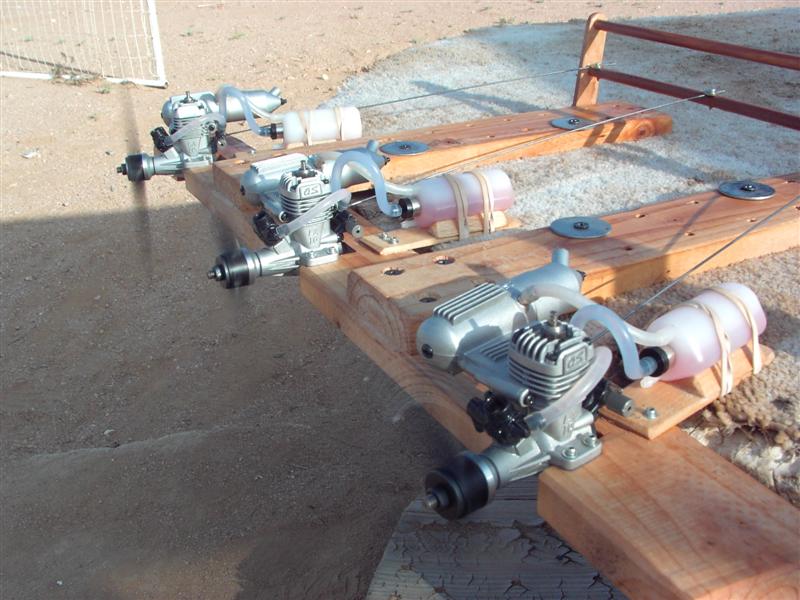

Here are some of mine and in one case one for multi engines, This one for a trimotor.
John

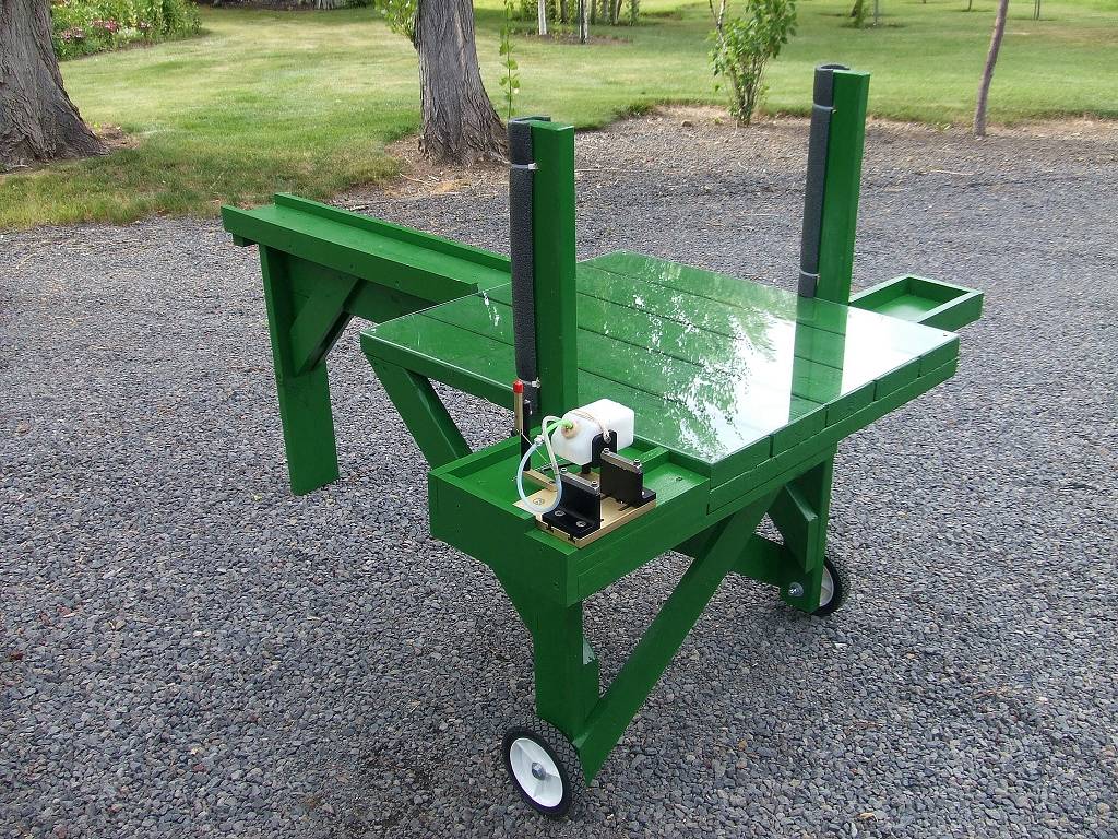

Heres mine. I just finished it.

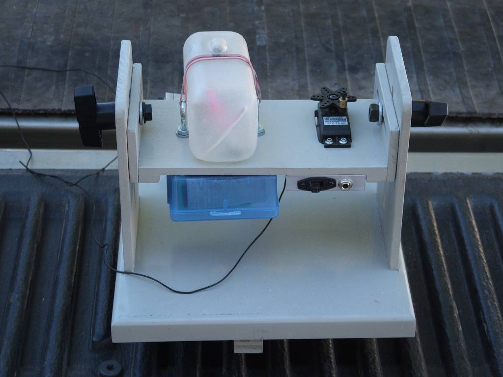

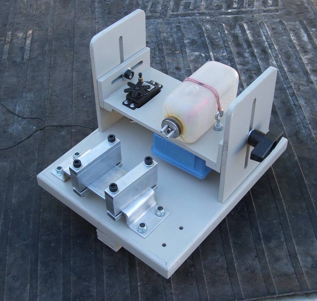

Okay, here are pictures of the test stand I made after asking this question.
The base is 3/4" Maple covered cabinet grade plywood from my scrap pile.
The super structure is Poplar. The paint is Fusion.
Here is a link to the actual engine mounting bracket:
[link]http://www.modelshops.org/model-engine-test-stand/model-engine-test-stand.php[/link]
Please note, on the base it can be moved from side to side for a better fit.
The receiver and battery are in a plastic (Hitec servo) box for fuel protection.
The base is designed to be used with my B&D Shop Mate.
If you have any questions feel free to ask, I'll answer to the best of my ability.

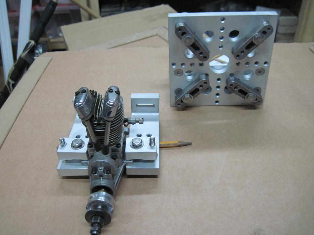

The machined one has a locating pin on each side, I offset the tank on both for rear exhaust motors, and use soft wire with a Z bend for throttle control. It is fairly soft and stays where you put it. They both have limitations. the manufactured one sometimes makes it impossible to use a muffler because of the big wing nuts, and the one I machined doesn't fit a rear rotor motor. I guess I could machine some material away.

I just made the aluminum one myself out of 1/4" .  I guess you could purchase one from me or get someone else to make it locally. It likely took a couple of hours. I just made mine because the other one didn't fit .049 motors and I needed something else. I really don't use them much for breaking in like the other guy speedracerntrixie says.  I did test out a whole bunch of motors over the winter just to sort out the slower and faster ones, and to see if some swap meet deals worked and it came in handy.

ORIGINAL: aspeed
Hi aspeed thats likely since when that pattern for those old Tatones was first produced in the sixties, as you know a time when mufflers were for cars not airplanes
You can use it for some Half A's even with some mufflers. The last time for me in one of my Tatones was my little MP Jet.051 diesel and it has a muffler as well as a throttle. The trick is to loose the big quarter twenty wing nut and replace with a thin Quarter twenty hex nut. Another trick to use the tatones with the little guys is to grind down the bump behind the stud base and the length of the stud itself a bit.
And I do agree with you there really is no such thing as a one size fits all with stands. While I do not use them for every engine I do find them a far better way to 'learn' a new engine to me.
