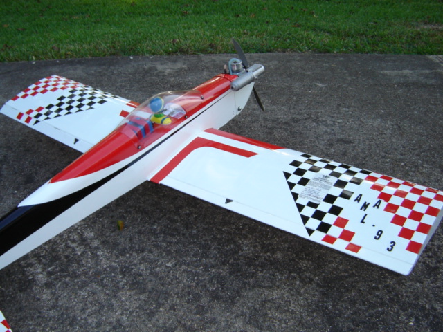

Just a thought about something I do most of the time with any non-scale model that has strip ailerons all the way to the tips. Maybe it will be helpfull to some of you folks and not just beginners.
1. Especially with wings that are less than symetrical, I cut the aileron at about 3 to 4 Inches from the tip. I glue that portion back to the wing with about 3-5 degrees UP. To add a hinge to the end of the remaining aileron is rather easy.
2.Cut a normal slot in the aileron. Same for the wing if the aileron is not yet fixed in place. Place a hinge in that end area.
3.If the aileron is already hinged, do the slot in the aileron by bending it down or up and make a slot with a knife. Then cut a small piece of the trailing edge away to accept the other end of the hinge. Then glue it back in place. It's out of sight and it will hold the aileron in place.
You will be very surprised what this bit of effectively, "washout" does for your slow flight, especially landing speeds. I learned this way back when I found that with Scale Warbirds, Take-offs and Landings became much easier if the entire aileron was raised about 3-8 degrees above the main wing. When it's right, that old booger, Tip-Stall, pretty much disappears.
The above assumes that you have laterally balanced your model.
EDITED:
Didn't mean for two pictures. The cut and redo is not shown here, just the ailerons to full wing length. This was for club racing but since that is over, I cut the aileron 3.5 inches bacl. Landings are smooth and easy. No sudden yaw & r0ll on take-off as before.

Washout use to be built into about everything. We've tended away from it.
It works by preventing the tips from stalling before the rest of the wing. Tip stalls are why old timers warn not to start with warbirds. Some (real and model) had a very nasty tendency to stall violently - even at non-landing speeds when that wing began to stall from maneuvers. Foamies tend to have some - possibly caused by the wing warping more the further it is from the fuselage.
