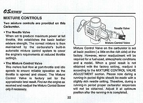

In all fairness since tuning by the bench commitee seldom acheves much joy and just two runs on a brand new engine, One just has to ask the Obvious question and that simply is did any single one of those six realize that this was an AX engine? And that all AX's except the old .46AX utilise a completely different carburation system. This with the mid range or low range needle whatever you care to call it in a completely different location on the left side of the engine in the end of the fuel inlet cone.
I have seen bench commitees experts repetedly stick a screw driver in the end of the throttle
barrel thanking they had actually adjusted the mid/low range while in fact accompishing nothing.
John

John,
The low end mixture is in the same location as all of my FX's. We all know what it looks like and how it operates. Take a look at the manual if you need to. None of us are new at this.

Actually I have read my manuals (all of them) and I actually do own multiples of the AX's including the `.25, .35, .55, .65 and one .95AX. All have the new carb system. Further one only has to look the 75AX up and its clear that agine its the same new carb.
Once agine the only AX that had the old double needle in the throttle barrel is the .46AX and as a matter of fact there is a new Series 11 .46 not quite released yet that will be the same as all the other AX's with the new carb.
I am not new at this either and I actually do own many of the series engine in question and once agine the low/mid range screw is decidely not where it is on any FX engine, In fact its on the opposite side of the carb from where the bench crowd always expects it to be.
There is no doubt in my mind that this fellow with all the 'bad luck' with a brand new .75 AX actually was caused by bad advise from the bench crowd.
John
#60
Your manual attachment is correct and notice the mid/low range is on the left side of the engine on the fuel inlet cone and it is not on the right side of the the engine in the throttle barrel/throttle arm such as it is on all the FX engines and that is what you implied earlier.
There is no comparison to the FX carbs that you suggested and I have repeatedly watched folks stick a screw driver in the throttle barrel thinking they were adjusting the mid/low range.
This simple error that is common with bench committees needs to be pointed out and cleared up before suggesting someone has a defective engine and needs to be sent back after only two runs or whatever you orginally posted.
John
John

John............I don't know what you are talking about............I am staring at 2 91FX engines and the mid/low range adjustments are in the exact same place as the 75AX and I also find it very demeaning that you keep referring to "bench committees" Some of you sefl-proclaimed "experts" should refrain from talking without thinking.
