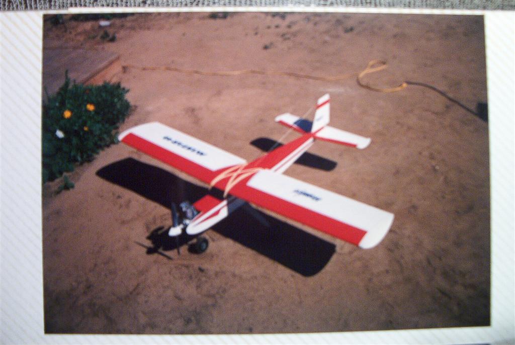

Here's a real early pic of the first Avistar arf back in 1991. Sorry for the poor quality it's a picture of a picture, we had no digital cameras back then.
Mine started with a O.S. 61 4 stroke and then I wedged my first O.S. 91 4 stroke on it.
Had alot of fun with this setup. Only other suggestion I might make is turn it into a taildragger.
This early version also had a semi symetrical wing which had a bit of dihedral which was removed, I think as stated this newer one has a flat bottom wing.
