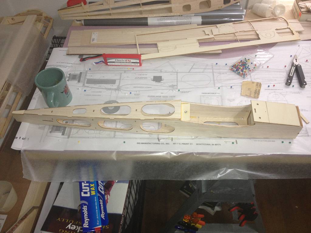

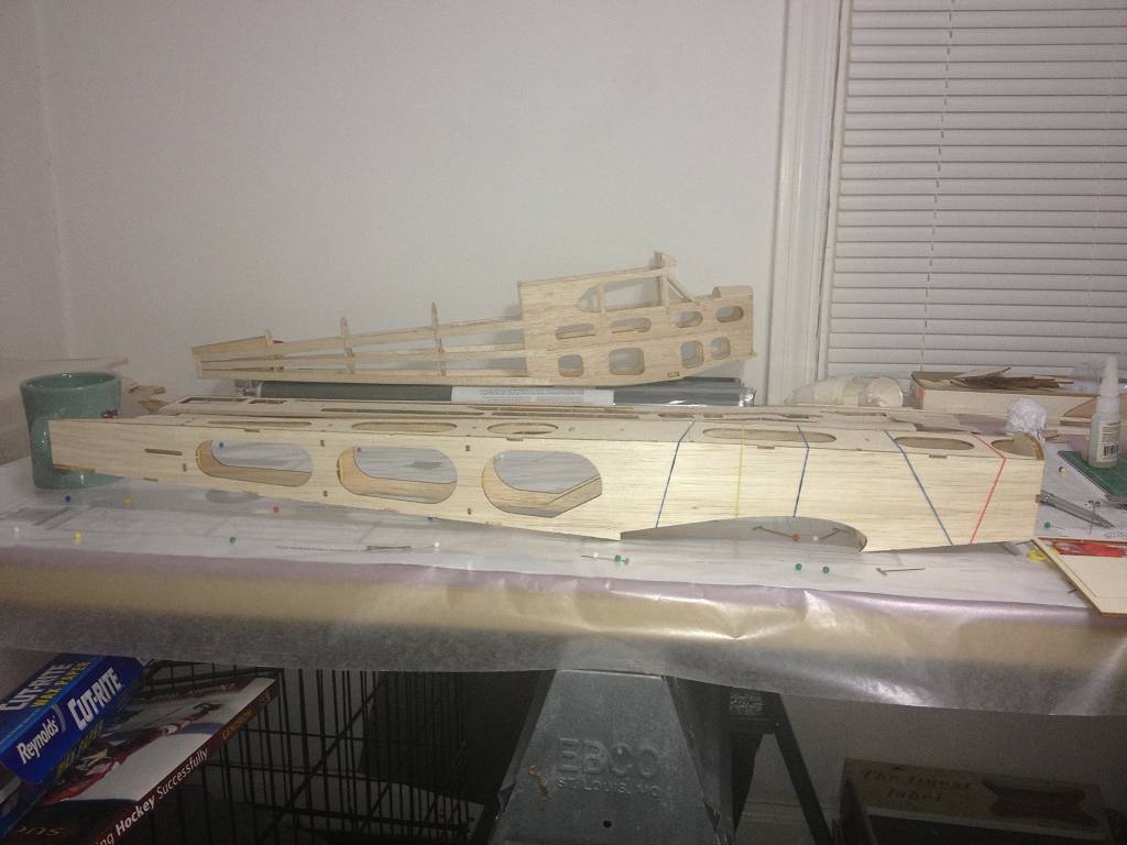

Hi everyone. This may not be the best place for this, but I figuered I'm a beginner and would have some questions as I go.
Not relly doing a detailed build log here. Just thought I'd get a thread started to post some pics and have a place to ask questions as they arise.
This is actually my second kit. I have a Great Planes Electricub started. But after talking with guys at the flying field, they felt that wouldn't be a great candidate for my second plane. They recomended a Sig 4*. So this is what I have.
I've started the build and about 3 days into it. Not sure how many hours so far. But not many. Compared to the Cub, this plane is going together like a dream. The parts are great and they actually fit the plans. I"ve had no issues so far. I have the elevator and stabilizer completed and both wing halves very close to being able to join. I"m holding off on joining them until last minute. Just easier for me to have 2 small wings sitting rather than one large one.
Here is what I have to get it in the air.
Motor: Rimfire .10 350W 1250kv
ESC: Silver Series 45A
Battery: Lipo 3S 11.1V 3200mAh 25C (Not sure I can make this battery fit. May have to go a bit smaller)
Prop: 10-6
Servo: 4 Hitec HS-81
That about it for now. Hope to get it in the air before the snow flies.
Here are the pics so far.

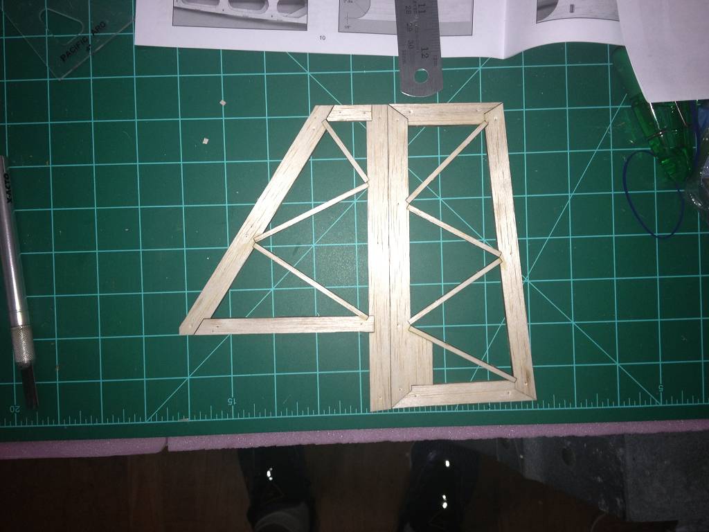

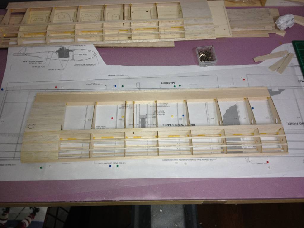

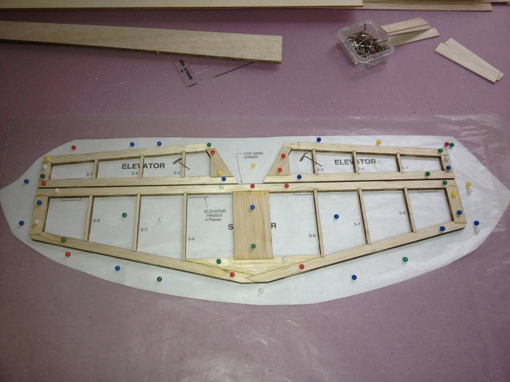

The 4* is a great flying plane, but as a first plane, I would be hesitant to fly it unless you are on a buddy box. They do take off and land like the Kadet, but they can also fly circles around the Kadet. I have a 4*120 on the table as well that I am building. Looks like you got a good plan too, the foam board works great, used the same setup when I built my P-51. <div>

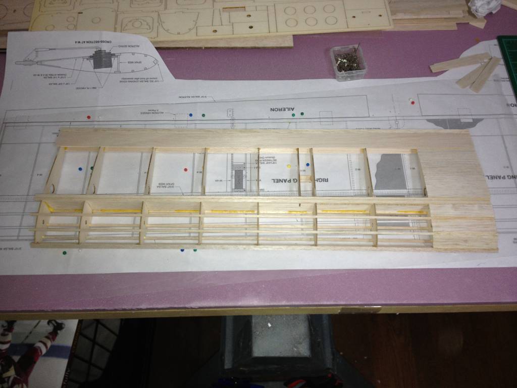

</div><div>A tip to take right now, put more glue on those sheer webs, looks like you only have parts glued with Aliphatic, you will want 100% gluing on those, front and back. Also, you may want to use some fiberglass tape and CA when it comes time to put the wire joiner on your elevators, as it will work loose over time and give you slop. You would just need a strip to cover it and lap it around each side of the elevator and then glue it down good. </div>

Acdii,
Thanks for the input. I'll be sure to go back and fill in the gaps with glue. I was thinking Ishould do that after reading your thread in the crash/rebuilld section. Glad to hear Sig took care of you btw. I'll be watching your new build to get some pointers on mine as I'm sure they are built simular.
As for my first plane, this is my second build. Well, kind of. I have another kit started and put on hold. This is actually my second plane. I have a foam supercub that I've been flying all summer. And I'm part of a club. They recommended the 4* for a second plane. They told me they would buddy box with me if needed.
Thanks for the wing imput. I'm working on the fuselage now. I'll post pics when I can. Looking forward to your imput.

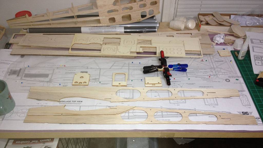

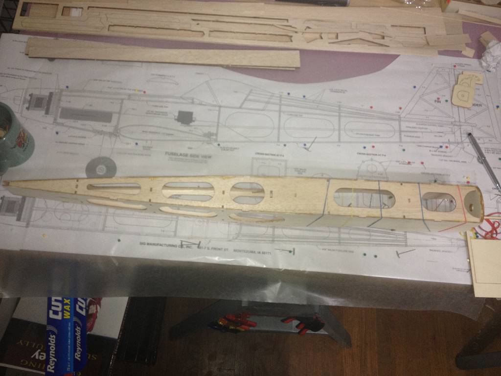

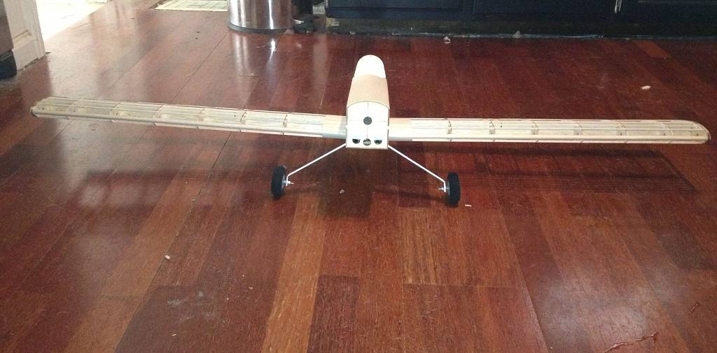

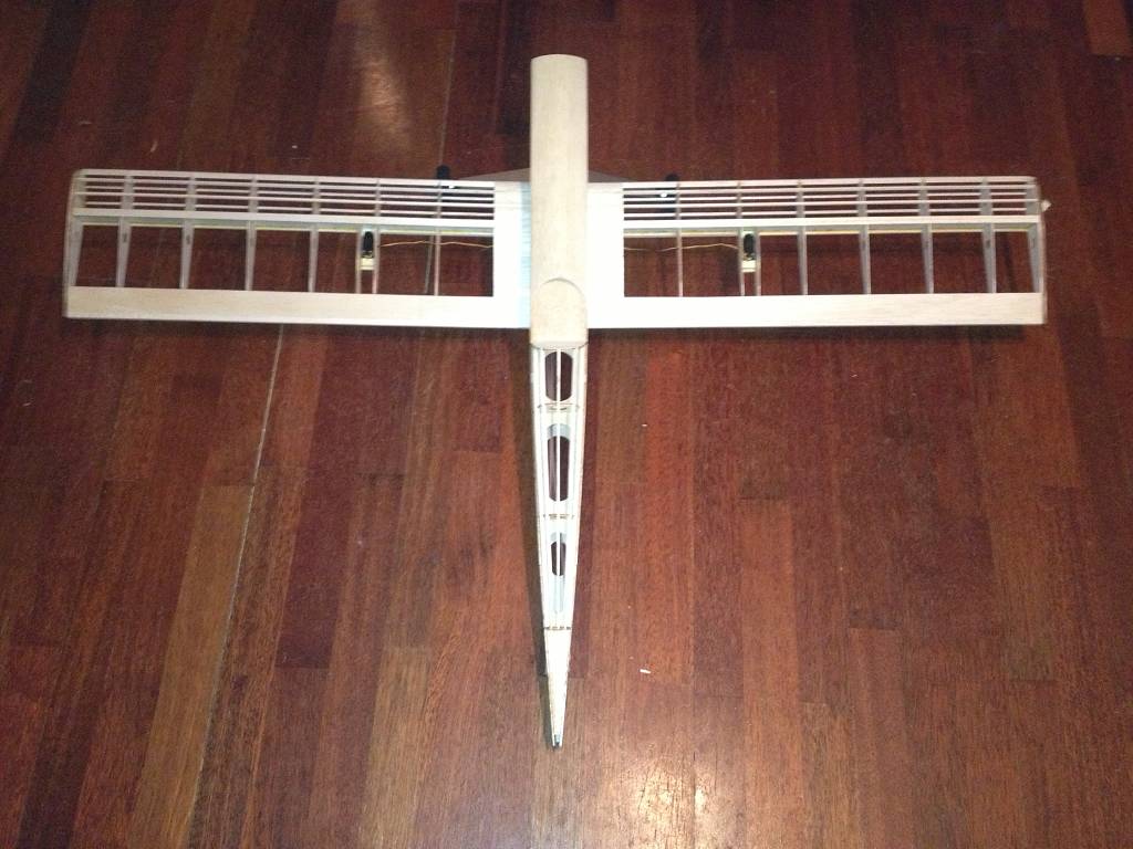

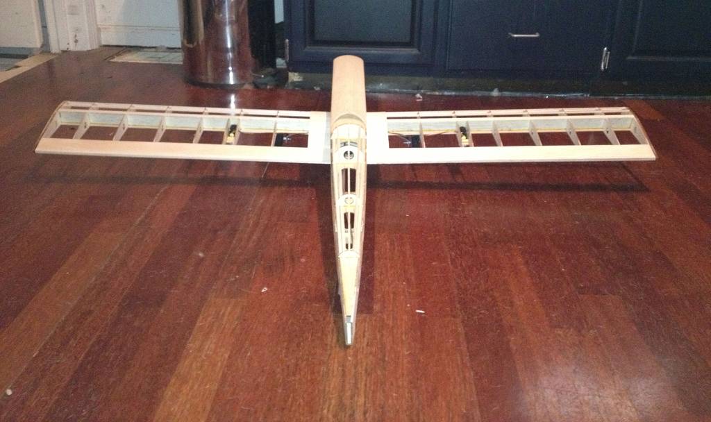

Well, got a bit more done in the last couple of days. Havent had too much time to work on it. But its progressing pretty well. I've made a few rookie mistakes I think. I mis understood the directions and glued the fuselage doubler in a bit too low. Nothing seems unfixable without sanding though.
Other than that, I have the battery tray in. I chose to build it to plan as opposed to cutting hatch in the top as I've seen in some builds. I just didn't feel comfortable doing that at this stage of my experience. Speaking of the battery, It appears that my big 3200mAh battery will fit in the designed bay. Just not sure if its going to be too heavy though. It feels like a ton. I was thinking of putting a former in the middle of the plane to act as a stop for the battery, as I was thinking of trying to put it as far back towards the CG as possible. The current set up doesn't seem like its very secure to me.
So as of date, I have the tail feathers all completed minus shaping and hinging, wings pretty much done, and fuselage very close to being completed. I have to say, while I don't have much experience in building, this kit is by far better than the GP Electrocub as far as parts fitting. This appears to be a very good kit for a first build. Hopefully its the perfect second airplane to fly.
Some more pics.

Before I hard mount anything in a build I finish the plane, install the servos, controls and engine/motor. Everything that has a place it must go. Then while still in the bones I set the plane on the CG machine and use tape to hold the parts like your battery in different places to get the planes CG. Then once I get that I hard mount the parts inside the plane then cover it. Most of my builds are ready to fly while still in the bones. I have even set up the controls in several of them. I do this before covering so I can get my fingers into those tight places and changes can be made.
Just something to think about at this point. If the servos and controls aren't in the way I leave them in while covering. Once CGed there is no reason to remove them.

Good call. That makes a lot of sense. Thats why Istarted this thread.

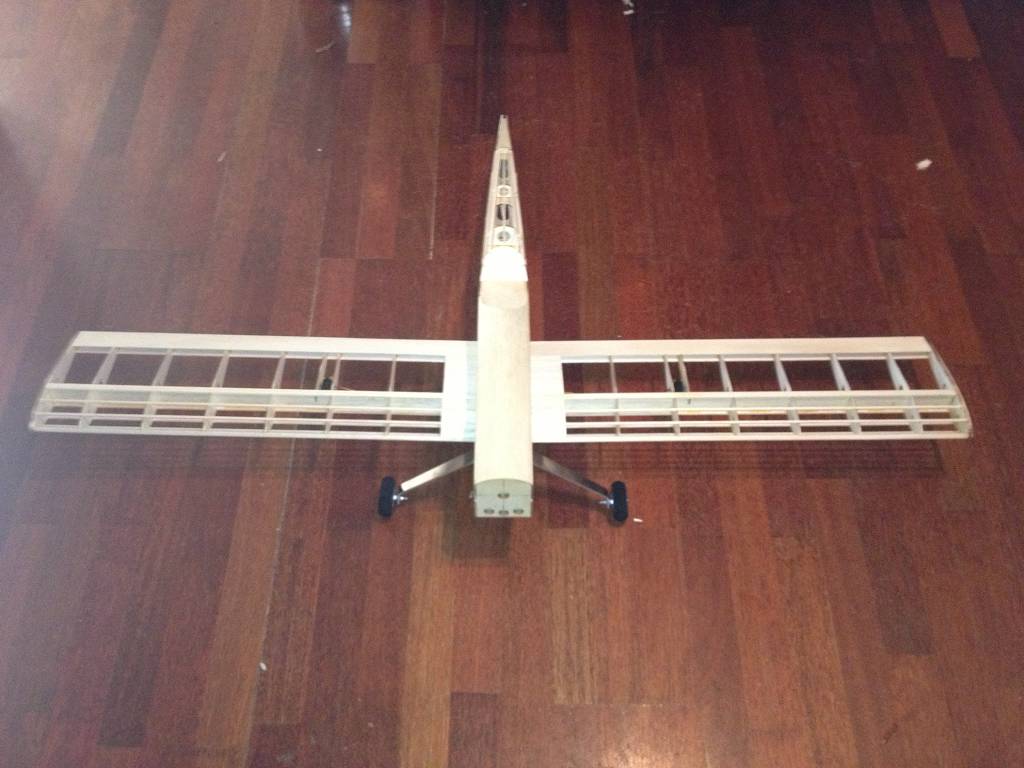

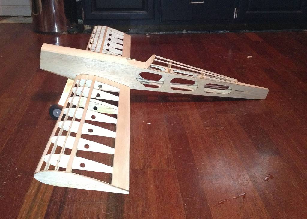

Well, my timeline wasnt quite what I had hoped for. Still havent started covering, as I havent been able to work as much as I would like. I figured that I should probably do yard work and this other thing called work has gotten in the way. And Im trying to close on some property.
But Ive been slowly pushing on and have the wing 99% done, as is the fuselage. Tail surfaces are ready for covering.
I have some questions as far as radio/ motor set up. My plans do not show where the ESC goes. Any suggestions for this? I know it should go somewhere that it will get some airflow to stay cool. But other than that, no idea.
I plan on putting the reciever as far back as possible, depending on the CG. Any suggestions on mounting that?
Also what are the opinions on cutting hinges? I mean, my plans show that they should be cut after shaping the surface and covering, while the plans for my Cub say that they should be cut before shaping and covering. Opinions? I cut mine before shaping and covering. Seemed to me that it would be easier that way. Only thing I can see being a problem is locating the slots after covering.
Thats about it for now.

I did get some pics today. And got an approximate weight so far. Looks like Im going to come in right at 32oz without covering. Thats with the big 3200mAh battery. Just have a few more things to do and try to get everything mounted properly.
Too bad I basicly lost a week to other stuff. The weather has been awesome here for late Oct.
Getting close.

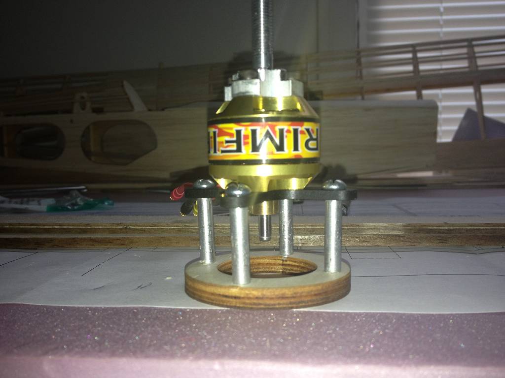

As for the plane, I'm getting around to mount the motor. This is my set up. I plan on epoxying the spacer to the firewall and the standoffs into the spacer. Here are a couple of pics. Anybody see any issues with this?
