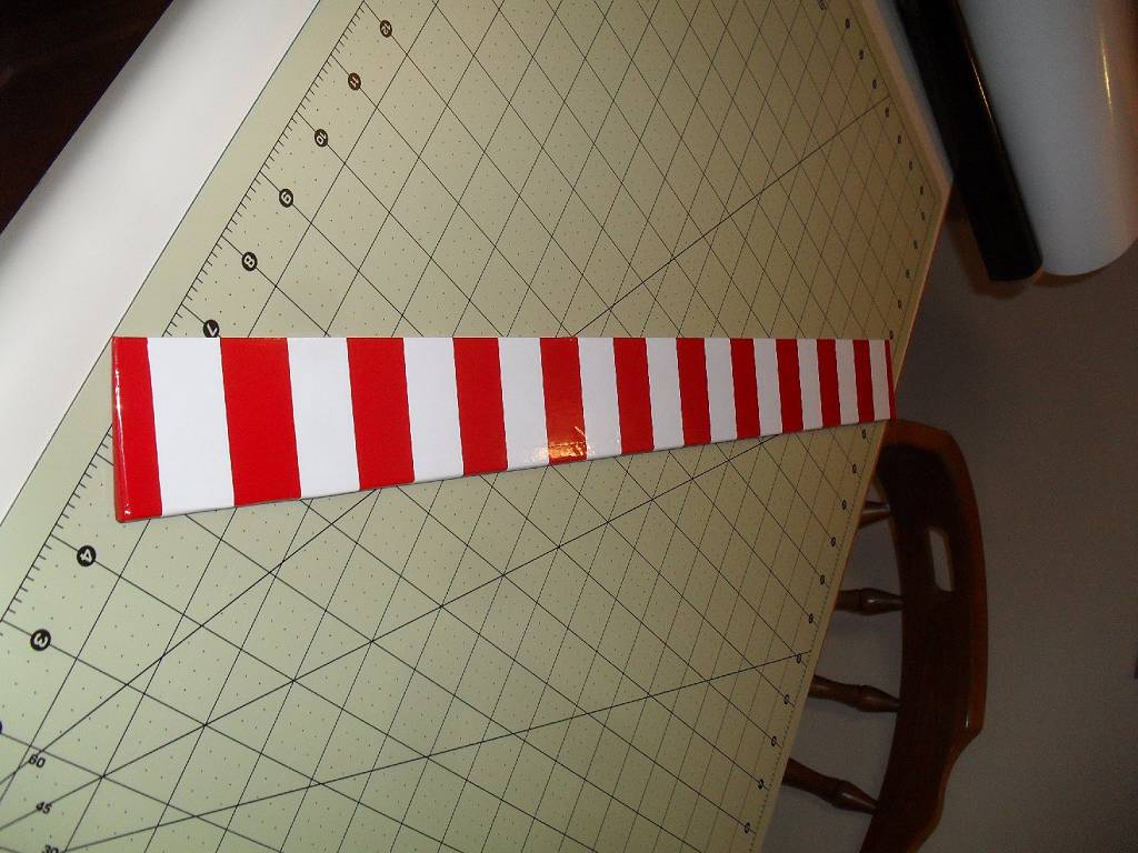

Finally decided on a theme for my 1st kit ( Sig Kadet Mark II ) Being from Indiana I can't believe I didn't think of it sooner. Oh well, I have some extra colors of Ultracote for the next plane. Just need some Red and White for this one.
This is my 1st attempt at covering a plane, just finished my Elevator tonight..

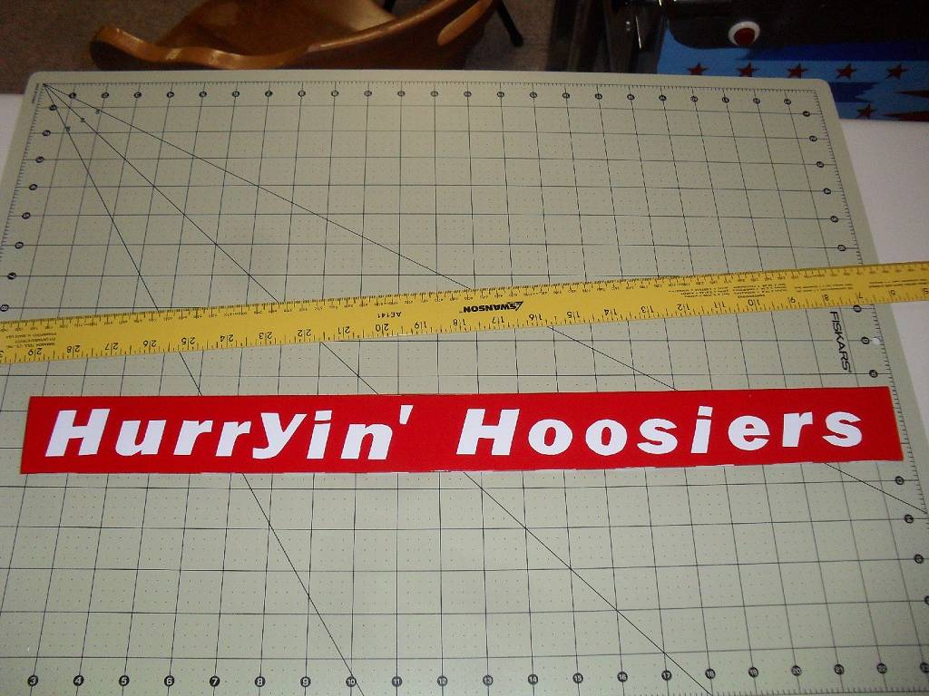

Back to my trainer, I realized that the covering process is the hardest part of the whole build.. I cut my own letters out of Ultracote. That took forever. I used a graphics program to mirror the text and print it out.. I then took the printed text and used watered down Elmer's glue to glue it to the backing of the Ultracote. I'm not sure which is the correct side to cut through, but the back seems like it grips straight edges etc a little better and like I said I could glue my paper to it, so I been cutting through the back.. I know they're not perfect, but hey it's my 1st try, so I'm satisfied with them.<br type="_moz" />

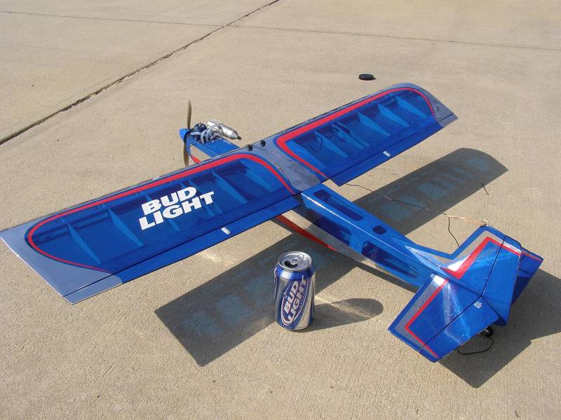

Hey Bill, I once too built and covered a plane by one of my favorite things...

ORIGINAL: Mr67Stang
Looks Great and Good all at the same time !

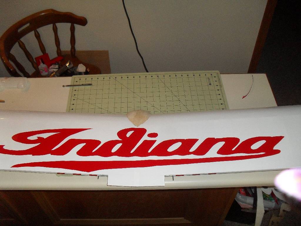

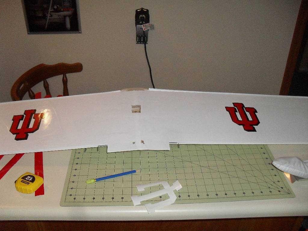

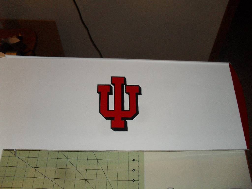

Top of Wings.... GO INDIANA !!!
edit..

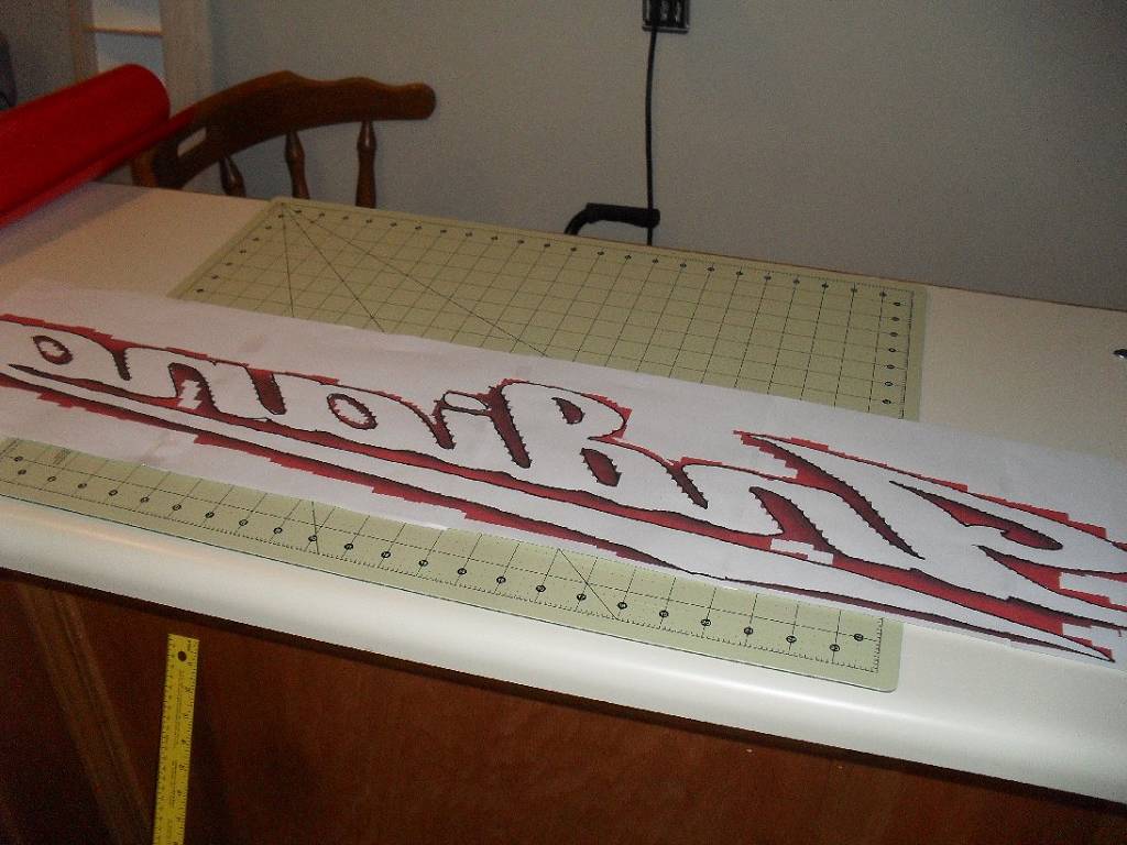

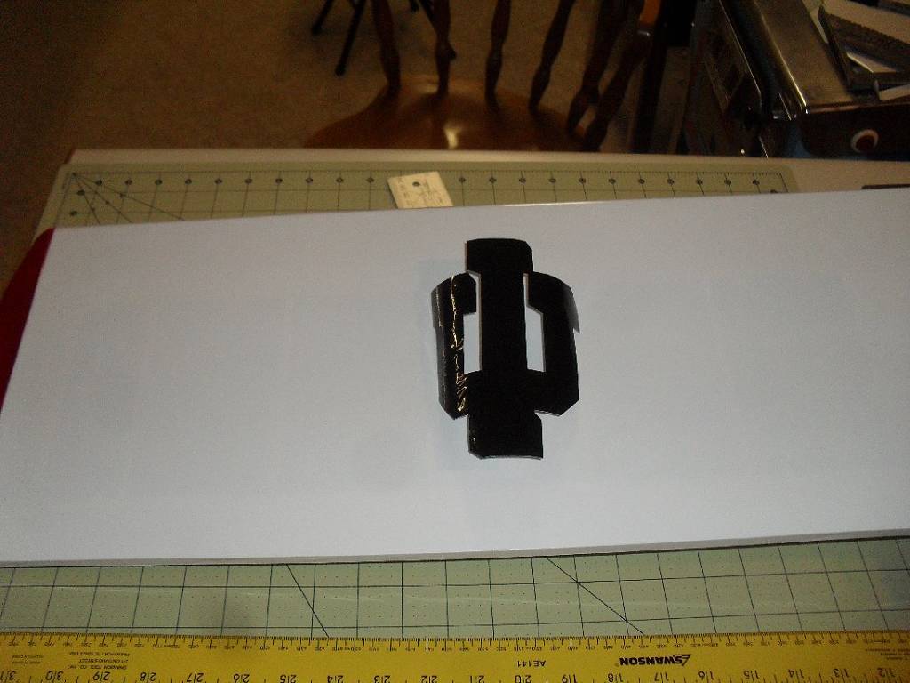

pic 1.. I mirrored and enlarged the cursive Indiana logo
pic 2 ... Cut out Indiana logo with a surgical scalpel
pic 3 ... After an half an hour of trying to get the logo centered and level..... I iron it on...Haha<br type="_moz" />

I found a Google image of the "Indiana" in cursive and used a graphics program called Paint Shop Pro to enlarge and mirror the image.. I then cut it up with that same program into sections the size of my printer paper.. 8.5" x 11" or so.. I Scotch taped them all together and used diluted Elmer's glue and a paintbrush to glue them to the Ultraote's paper backing.. Cut it all out with a #3 scalpel with #10 scalpel blade..
It's not "Laser" cut, but I'm happy with my results...LOL<br type="_moz" />

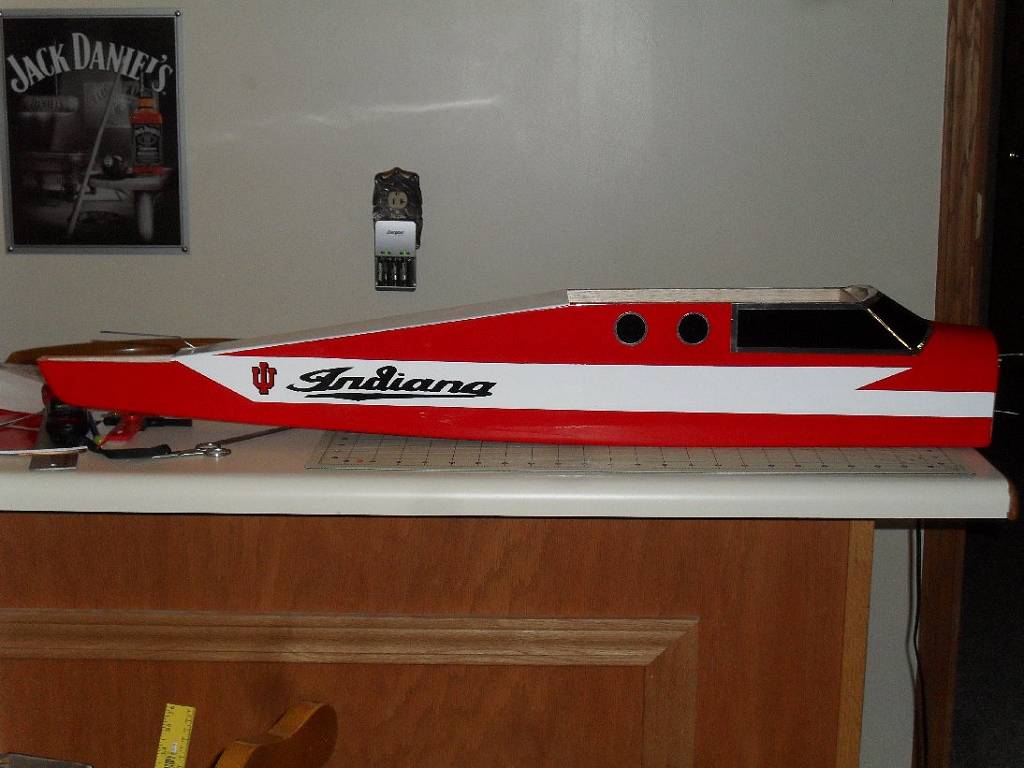

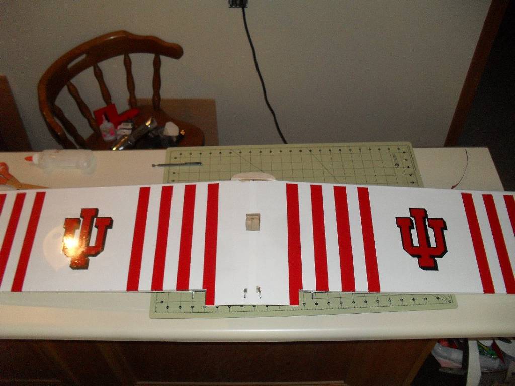

A few more pics of my progress.

Wow...Fantastic..Your first ? Common now you gotta have some experience to be that good...Do you hone your blades to keep them sharp ? Or how do you get them to hold an edge ? Change them every few ft ..

INDIANA!!! It is supposed to be ND-Go Irish. BTW it does look good. Nice job.

ORIGINAL: bikerbc

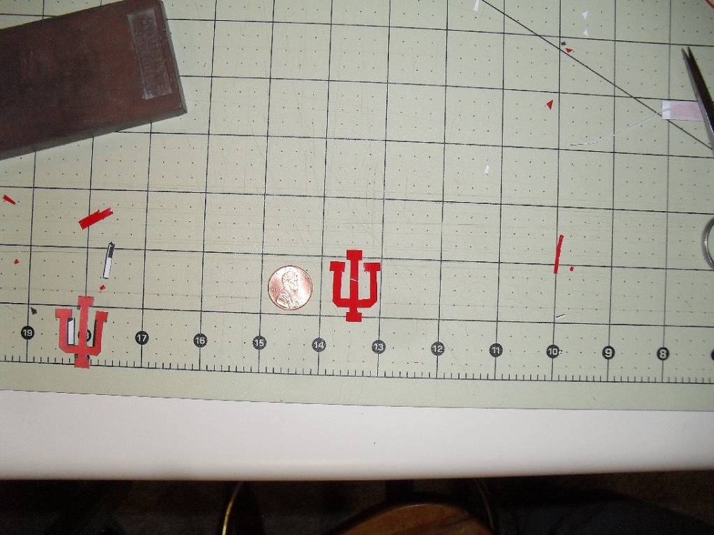

I have a hone that I swipe my blades on every few cuts. You can actually see it in the pic of the little red IU and penny.. It also works as a great little weight for whatever..
Thanks for the compliments. This is my 1st. I couldn't imagine doing a plane without my computer, printer and a graphics program. It allows me to make mirrored images to glue right to the back of the Ultracote.. I still have to cut them out by hand, but I can't see spending a bunch of money on a vinyl cutter or plotter. I'm just a beginner so there are many small imperfections that bug me, but not enought to spend the cash on a plotter.
