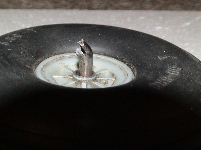

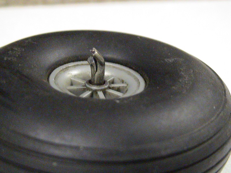

Just last Sunday I had an accident with my HobbiStar [] – regular nosegear strut snapped on landing. Not just snapped – at the bend point it split!!! [&o] Everybody on the field came to see it. Nobody, even our veterans, saw anything like this before (I might post picture of this thing later).
Lucky me the strut was only damage. So I ran to a hobby shop and without second thought got myself a set of Fults. Little bit more expensive, but to me it a must have, especially for the trainer.

However, be a bit careful about making the gear too stiff, as the energy on a hard landing has to go somewhere. I'd rather bend nose the gear than remove the firewall for example. A good strut, single or double, should have a good spring to help with this though.
I've also never heard of a nose strut breaking. Sounds like it was defective materials.

As promised. Attached are the pictures of the snapped strut.
The split you see is "as-is" - the way I founded the wheel after the landing.
I think this is an agreement among those who saw this - "it must be a defective material".

bad joint. probably uneven heating, or something contaminated the metal. it looks like it was cut then ripped apart.
