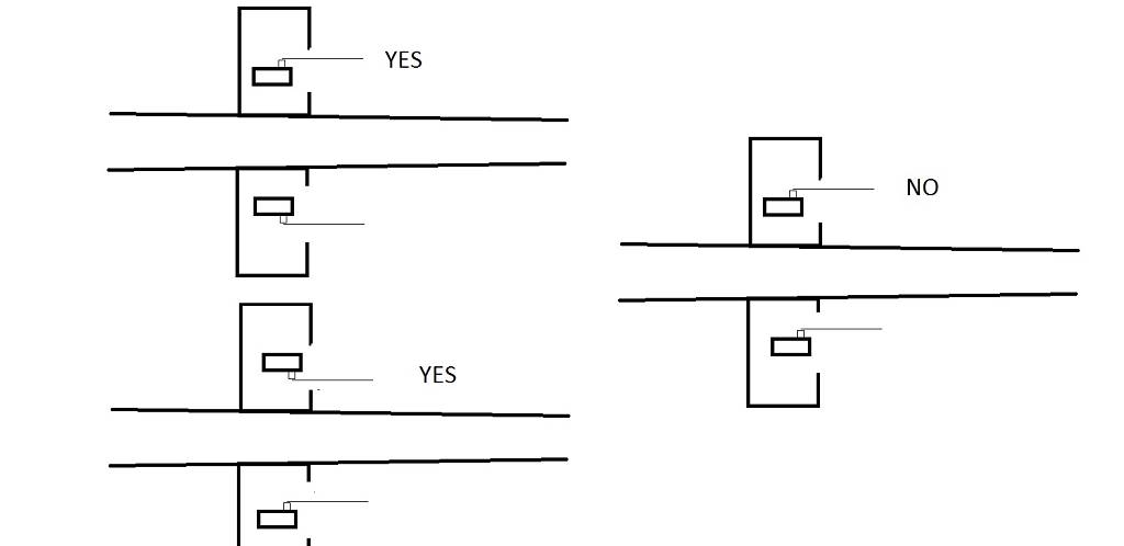

I’m installing a AR6210 receiver in my new plane with the DX6i transmitter. I have the EMS Heavy Duty Y-Harness. After I bind the receiver the ailerons both move the same way. How can I reverse the other aleron?

Default RE: Aleron Problems
When you say "the wrong side", what do you mean? Take a look at the quick sketch. The one on the right is not the correct method. This will have both going the same way. The setups on the left are the right way to do aileron servos. I just want to make sure the OP knows what the proper setup is. Both servo arms on the inside or the outside, but not one on the inside and one on the outside. This will work just fine with a Y cable to one receiver channel (aileron channel).
CGr.

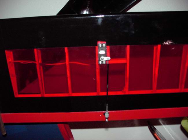

CGR's excellent drawing illustrates what we have been trying to describe verbally when one chooses to use a Y cord on two airlron servos Also there is nothing wrong with useing that method.
I realize mrcoolpop that you have fixed your problem by orienting your backward servo that the CGR drawing shows but in case there others out there with the same problem but their Servos are a surface mount This is how the orentation is done. Surface mount are real common with small foamys.
In this case the servo arms must point on both sides either both toward there respective wing tips or both toward the fuselage and this will also give you the proper goemetry to properly operate your servos with a Y cord.
Both of these methods either the servo flat on a mounting plate or the surface mount is a good habit to get into even when you are not using a Y cord but two channels instead.
In these pictures the Red airplanes have the servo arms arraigned to point to the wing tips on both wings but they could also both point toward the fuselage just as well such as the yellow wing:
John
