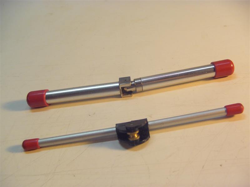

Du-Bro makes a set of tubing benders for small tubing 1/8" and 5/32" that work pretty good...You cant bend hard tubing, you need to anneal it first...I have the spring set too and I use them on the larger tubing but I dont find much use for them building my planes...The Du-Bro tool number is 785(A) and 786(B) They are sort of like pliers that the tubing fits into.. I really like them for fuel tubing ..They have a video demo on line , that might be worth a look

This is the Dubro tube bender that bikerbc is talking about and I agree it does work pretty good and it is reasonably inexpensive and far far better than the springs which present the problem of removing the tube from the spring if you bend the tube to much. That is a major problem with the springs, They are quite limited.
It is the tool at the bottom, the other one is the now discontinued Dubro Z bender. If you should ever run across one snag it fast it is a marvelous tool and much better than the heavy one they sell now which requires bolting to a bench.
Or as I indicated in my prior post and since I have have changed over almost entirely to Hayes tanks which use no brass, aluminium or plastic tubing that bender gets little or no use now for some years.
John
Whoops the RCU's providers are feeling cranky agine and don,t like my pictures - will add the pics when they are cooperating agine.

The Dubro benders make beautiful bends and very tight bends if needed. Only 2 sizes available but plenty for most fuel lines.
