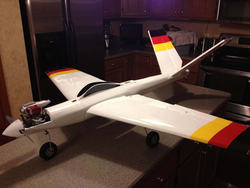

Just finished building by Simple Flier (kit) and it came in too heavy. Kits calls out 5.1lbs. Mine wieghs 6lbs 3oz. I wonder if this is too much? I can do a couple of things to remove a little wieghts but I would rather not. (everyone knows this feeling). Does anyone know of a genral rule of thumb on precentage of wieght planes should try to be within in regards to wieght? Also would it be any advantage to go with lipo over my NiMh? I would have to have some type of voltage regulator with the lipo I guess as I need to be at 6Volts.

Typically speaking all the kit makers were a little light on weigh estimates. I am thinking I would head out to the field and fly it. As for lipo's, I got rid of all my nicad packs and switched to lipo and a Castle regulator. I was having to many nicad packs fail to keep screwing around with them. Good Luck, Dave
I would expect the stall speed to be a bit higher but otherwise the plane will likely fly fine.

Beautiful flying machine. Since I have no clue as to the size and weight you actually have I will just say some points in answer to your ??s concerning rule of thumb.
For airplanes with under 800 square inches wing area, a good general of thumb is not more than 1 pound per 100 sq. ins. wing area. All have flown heavier but it can get tricky. Ove 800 squares it seems OK to go a bit more weight per 100 square inches. You have a long nose-moment arm and a relatively short tail-moment arm. I sugest you not get too slow on approaches or quick-on-the draw when rounding out.
One item that I use frequently is some form of washout for most all airplanes, especially heavy ones. I can't really determine where the end of your ailerons are. If they do continue to the end of the wing I suggest that you cut them about 5-10% of length at the tips and glue the small cut-off portion to the Trailing Edge OF THE WING WITH ABOUT 2-3 DEGREES up. If that is impractical, then at least TAPER the last 15 to 20% of the ailerons Trailing Edge to at least only 50% of the aileron's main chord at the tip.
This "washout" will make landings and tight turns far less subject to the old "Tip Stall" thing that sends many machines to an early grave, or at best a rebuild.

Hossfly, I calculated my area of the wing to be around 520 in.sq. The plane weighs 6.2 lbs. so Im overwieght. I did not inlcude the under belley of the plane/wing in the calc but if I did I would get a little more.

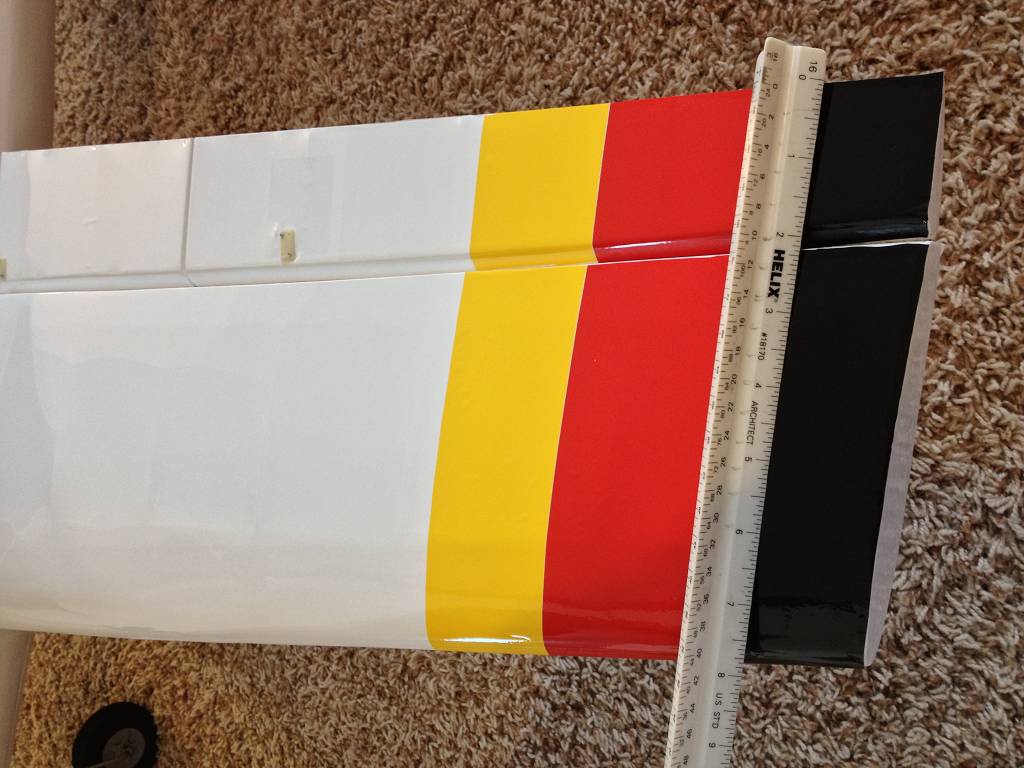

Attached is a better pic of my aileron. It is tapered to the end. it would meet the 50% rule if I use the flaps as part of the aileron. However I planned on deploying the flaps when landing. With that I would not meet the 50% rule. I have my radio programmed to have a few options with the flaps. 1. fully deployed/ do not travel with aileron, 2. travel with aileron full tiume, or 3. fully deployed/travel with aileron. Im scared of the tip stall as I have already destroyed one kit (RV-4) due to this.
I looked at the life batteries. Im going to get some as I too dont trust my Nimh.
Hard to tell from pic but my ailerons due taper to the end

Also I took a good look at the wing tips. There looks to be washout already built in to the wing as the leading edge is pointing lower than the wing root! (the wing has a slight twist) more good news!

OK first as everyone has indicated you are freaking out for no real reason, it would be rare indeed anytime a kit build or an arf comes out as advertized, that is in most every case BS. The simple fact of the matter is the manufacturer has a vested interest in not telling the truth.
Now you re measuring your wing area incorrectly, for all normal wing area calculations the area through the fuselage is included. Average chord x wingspan tip to tip thats it. Also the chord measurment will include any flaps or ailerons in trail.
If you have a bit of taper (leading edge, trailing edge, both or even eliptical) just midspan average to find that very simple measurement. all you gotta do is measure the chord half way out between the fuselage and the wing.
Now you can multiply the span by the average chord and you have your real wing area. But thats only half the information and not of much help in trying to get an idea of how the airplane is gonna fly. To finish the job you need to calculate wing loading and only then through yours and others experiances here we can begin to get a good idea as to how your airplane is going to fly. Wing loading expressed in ounces per square foot of wing area. That will be the magic number and its so easy to obtain.
It can be arrived at in just a few minutes but its a challange to write out and I have done it here many times but its
not worth it unless you are interested, so ask if want the simple calculation. Even if you will simply post the true span tip to tip including the fuselage and the (mac) average chord along with the actual weight in pounds or ounces without fuel I will post back with your actual Wing Loading. Thats the magic number that every designer will strive to acheve or improve as well as giving all the rest of us an idea as to the types of performance to be expected.
Now having typed all that (the only reason I did is because you seem to reallty want to learn and I like that) Ya'll need to chill just a little reflex the trailing edge of your ailerons up a smidge simply by extending the clevis a few turns Boom ya got washout baby and go fly that airplane.

Fly the plane.
I have a Tiger 120 that needed over a pound (in fact, 18 oz.) of nose weight to make the CG. I thought it would be way to heavy. It flew like any of the typical Goldberg Tiger aircraft, it flew just fine.
So, as stated, just fly the thing. If it were electric, that would be different because more calculations would be needed to pick the right power system (Battery pack, ESC, and motor). According to the OP, and the picture provided, the power is glow, so it probably will only make a difference in a slightly faster approach and landing speed.

There is a 25.4% increase in weight going from 5.1 lbs. to 6.3 lbs.
The wing area on the Simple Flier is 610 sq in.
The wing loading is 23.8 ozs./sq/ft 6.3 lbs.
The wing cube loading is 11.6,
Your flight characteristics should be in line with warbirds and racers if that is what you seek. By the way, nice looking job on your build.
