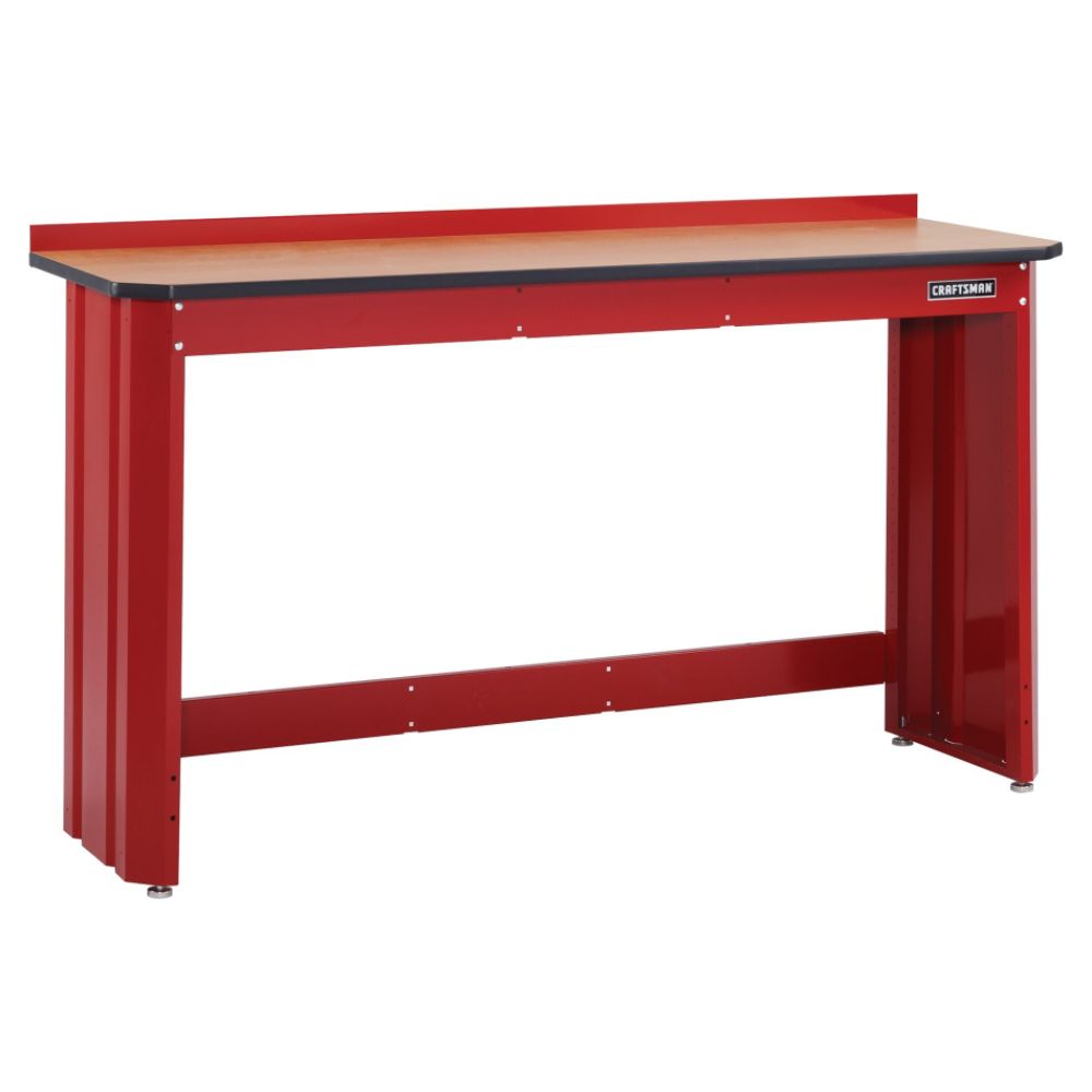

18 years after my father and I spent a year kit building a Telemaster 40 and I then subsequently spent 8 seconds taking it off on a first flight at my grandfathers farm and smoking it into the ground thus ending our RC aircraft building/flying endeavor, I've decided to pick it up again. I've spent a lot of time researching on the forums here and elsewhere what I need to get started. I plan on building a Sig LT40. I've figured out most all the things I need to get started as far as tools and equipment and Im ordering/buying that stuff now. I also recently bought a Sears craftsman 6 ft work bench along with some shelving and cabinetry to make a separate building/hobby area in my garage. I'm trying to plan out my work space before I get building.
One thing I'm confused about is a building board set up. The Craftsman workbench has a 1 inch think MDF top. If I can figure out that the top is level, can I not just put something soft enough to pin into (i.e. a ceiling tile or dry wall) and frame up on that? I'd love to get a magnetic board system, but I don't have the cash to sink into that right now. I've read a lot of threads on building boards and I've been looking at pictures of other peoples workshop setups trying to figure out if I should build on top of the Craftsman. Obviously if I had unlimited funds and more space in my garage I would get some huge sturdy metal top, metal framed bench to build on. I may be over thinking this somewhat, but I've read a lot of stuff that says its really imperative to have an absolutely flat surface and I'm just unsure if I can build on top of that bench or need to buy or make a separate building board to lay on top of the bench (like a 2x6 hollow core door)and build on that. I guess as long as the Craftsman top is flat that should be adequate correct? Since I plan on progressing to some more in depth models after the Kadet, I want to get it right from the start.
Thanks!
Thanks!
You should be fine with that assuming it is dead on flat, although it may be a little small for some projects. It shouldn't be too hard to build a flat work surface over that work top if it does turn out to have issues. Before sinking $100 into a precision straightedge, have a look at this article on making your own.

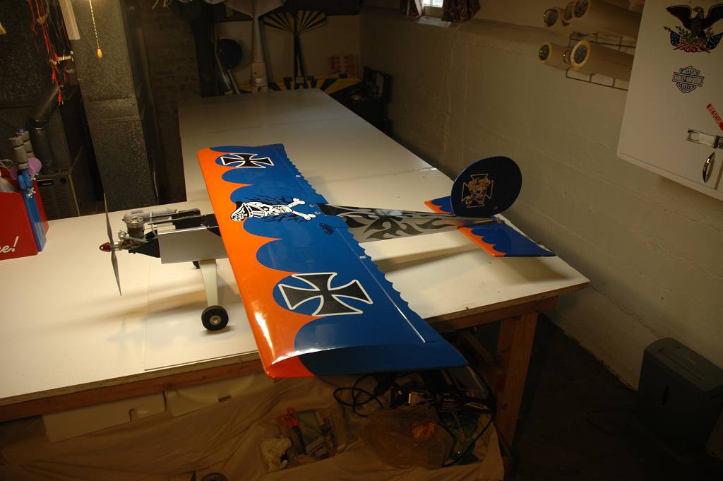

You're on the right track! I simply built two 4'x8' shop tables (see pic below) and covered them with 3/4 ply then a sheet of the buffalo board or chip board easy for pins to push into. You could cut one to the same size as your top for a custom look. You may want to paint a coat of cheap white latex on it that helps you find things on it because it's rather dark in color.
It's best to keep things simple low cost and just buy what you need to get the job at hand done and try not to reinvent the wheel. The tools will start to fill your shop as your building skills grow and you decide what you need for more complex projects. Things like scroll saws, belt sanders and the all useful Dremel tool are huge time savers. I just bought a small air die grinder with small sanding disks what a wonderful tool (see pic).

Sticktickler, I don't know if recommending HF is such a good idea. Almost everything I bought from HF was garbage that either fell apart taking it out of the package, died very quickly or needed extensive rework to get it to work properly. The only HF tool I still have is a bench top drill press and that's only because I was able to repair its problems enough to make it usable
My building table is just an 8' chipboard/veneer table with a sheet of 1/2" dry wall laid on top. My church was discarding the table from one of the sunday school rooms because the top was chipped and the legs were loose. I fixed the legs and the top didn't matter for what I was going to do with it. <div>

I've used drywall sheets for years and I used to do a lot of building. Yes you can pick up a sheet with something on it as long as you set it on something else that is flat.
Drywall is easy to work with and sometimes you can get a broken piece from Home Depot, Lowes or a lumber yard . When you get it just measure out what size you want, lay it flat and cut one side with a box knife then stand it up and cut the side that you didn't cut . Once cut on one side the other side will bend so you can see where to cut. NOT a big deal, you just have to do it.
Once you cut it take some tape ( any kind ) and tape all the edges . If you don't you will have a white streak across your belly . lol
You can put pins in it and cut on it as long as you don't go to deep . I used to use one side to build on then flip it over and do my covering on the other side. I did this in a 5th wheel for 12 years. And yes I think you are over thinking the whole thing. ENJOY !!! RED
The table is flat, but the drywall will even out any minor sags. If you have any doubts, you can use a straight edge or a 4' level to make sure your table is flat enough. You don't need a saw to cut dry wall. just a straight edge and a good utility knife will do the trick. They make a "T" square for drywall that makes this even easier, but you can use a metal ruler, a level, or any other suitable piece of metal as a straight edge. Use the straight edge as a guide for the utility knife and all you have to do is score the drywall 1/4 deep and break it off. It will break off nicely where you scored it, you may have to make a follow up cut through the backing paper if it doesn't tear off or break clean through.
