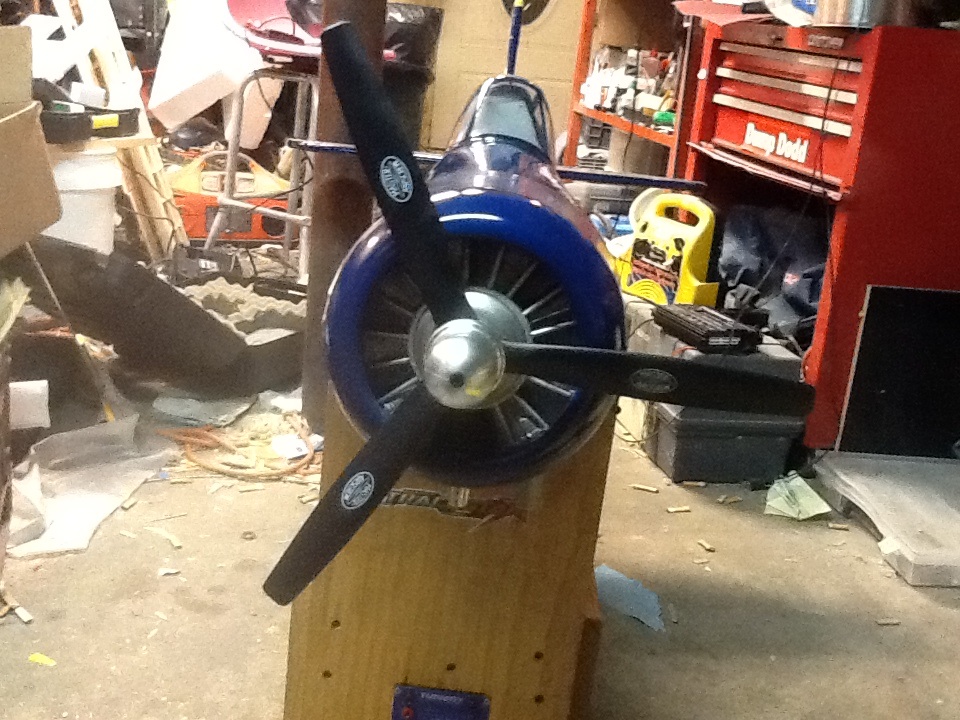

Since the P-47 is a warbird I would like to use a 3 blade prop, I wish I could use a 4 bladed prop but I haven't heard anything good about them so would it be the same as using a 3 bladed prop on a glow engine just go down an inch and one degree on the pitch so if it calls for a 15/7 could I use a 14/6 3 blade?
Old 05-10-2013 | 07:21 PM
stevegauth30's Avatar
Joined: Jun 2012
Posts: 4,002
From: Bristol, CT
Default RE: Gas Engine set up
I had a 16*8 on it and was making just about 14 lbs of thrust. With a 15*7 three blade it's making 14 lbs even. I haven't flown it yet, but I don't expect it to run too hot or anything. Looks and sounds great too.btw, that will be a perfect fit in the p47.
