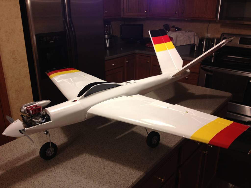

my plane flys better with flaps down. what can I do to transition to flying with flaps up? Should I trim the ailerons down? Should I trim the flaps down. Should I move the CG back?

It is an AK modelsSimple Flier. With flaps up the noze wants to dive, not real drastic but non the less it does. It did snap on me with flaps up. Luckly I was high enough to recover. So what do you think? I was thinking about moving the CG back. Also the Vtail control surfaces looked to be straight with the stabs so I dont think its out of trim real bad or anything. The CG is back a little from manufacture specs but is forward of what the CG calculator spec'ed out. I dont know...

So I did a couple of things to the plane tonight and took it for a run. First I added some weight (I think it was around 1.5 ounces) to the very end of the plane at the tail. This moved the CG about 0.5" to 0.75" back. Second I trimmed both ailerons down. I think it flew better. I crused around for about 5 min with no flaps. Seemed better, and no stallls. I did not lay off the throttle to much though.
I tried Charlies inverted flight test (trim guide) but first I trimmed for level upright flight. The nose definetly dropped down while inverted indicating a nose heavy airplane. In fact I could not make the nose go up by giving it down elevator. It just did not have enough ass, if you will, to overcome the weight.
So what do I do now? Add more weight to the back in order to move CG back? Yes I will move the battery back furhter too! Some more info that may help us is: the current CG is 4.5" from leading edge. The CG calculator says I need to be at 6". The manufacture spec says 3.5"

heres a pic of mine and yes thats a heli engine on it. Redline Pro53H. Really whines up!

I'd double check those calculations or either reread the manual. I've heard of CG recommendations being a little off before, but that's really bad. Either way though, you know you are nose heavy so moving the battery back is the first thing to do. It's not hard to make a hatch for it in the bottle of the fuselage and use velcro to secure it in. Moving servos back helps a little also, but the 2-3 inches you'll get inside the fuselage isn't worth the trouble. If you have to add weight you just have to do it, because as you've seen flying nose heavy just doesn't work.
No NOT necessarily.
The AMOUNT of nose drop is important.
If you can hold the plane level inverted while pushing the nose down, note how far you have to go to do so.
If you only need SOME stick movement you're fine.
If you need to practically move the stick to it's stop, it is definitely nose heavy.
This is NOT a 3D plane where we trim it to fly level upright and inverted... this is a swept wing plane....
If you move the C.G. back to far the plane will drop a wing severely at stall after it gets very mushy.
You WANT the plane to be just a little bit nose heavy... just like you would on a delta or jet.
Note Kitbuilder's comment... he is right on the money...
"Moving CG back increases INSTABILITY (aerobatic ability) which i believe will just compound your problem. This plane has a long nose and short tail moment... (centered wing)... looks like it needs speed throughout the flight envelope to behave... just my opinion."
It is that INSTABILITY you are encountering with the snap.
The fact that your plane wants to nose down when flying flaps up, indicates it is out of trim for level flight, there is an incidence problem, or a thrust line problem.
You need to check that all out first.
Forget about the flaps for the moment and ESPECIALLY dropping the ailerons as you've done as that INCREASES snap tendencies.
Equalize the ailerons then trim the plane for level flight with no flaps at around 70-80% throttle.
Then use a mix with flaps to prevent ballooning, but given the low speed symptoms you already stated you may want to trim the ailerons slightly UP not down to prevent tip stalls then greatly decrease the amount of flap travel.
When trimmed for level flight ( no flaps ), and flying at 50-60% throttle, does the nose pull down or up when you go to 100% throttle?
If so you have a thrust line problem.
