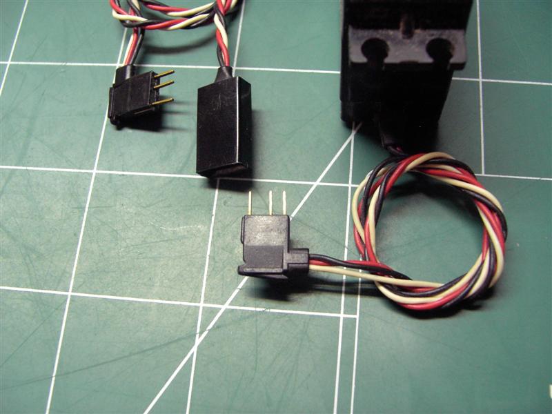

mmabc is the reason you said you obviously can,t use those futaba servos because they have plugs that look like this?
John

Thanks John. I think you've answered one of my big questions.I don't know why they didn't explain that in the manual or at least labelling on the receiver. And no, the connectors on my servos are the same as they are today. They will plug into the new receiver. I would assume then, as I've been hoping, that I can still use the servos. That will keep my startup costs down.

Those servo plugs I pictured are the old Futaba 'G' plug and those will not plug to a modern Rx without an adapter or a plug change. Since you have the modern J plug then there is no reason not to try those servos. They are probably an older series but no reason not to give them a shot.
