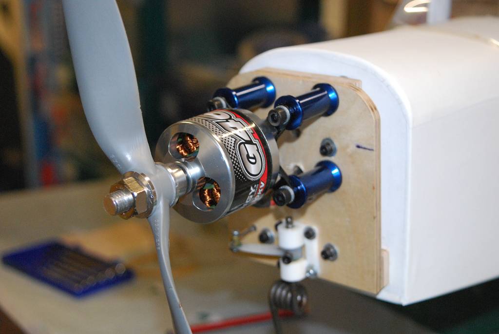

The Sig Kadet trainers are some of the best around. My particular favourite is the kit version of the Kadet Senior. And as a result I have three. The most recent build is about two years old and until a week or so ago, it had a Saito 90 R3 radial glow engine. I put the Saito into the Kadet to get to know the engine and I discovered that it is a nice sounding engine that makes very little power so for the time being it is back in its box.
I have two other Kadets Senior. One, which is now about 10 years old, has a Saito 62 and is my favourite model for teaching newbies the basics. The other has a modified wing with barn door ailerons and a Laser 70 four stroke engine. So I decided to try to make on into an electric powered model.
I chose a Turnigy G46 550kVa motor as I already had it and I used an APC 13 x 8 electric prop. The speed controller is a Turnigy Plush 60 Ampere one and the batteries I have been using are two 4 cell (14x8 Volt) 5000mAh Turnigy batteries.
The Kadet has plenty of room inside and so I cut a hatch in the bottom and the battery hangs from the bottom of what was the fuel tank mount with Velcro and some Velcro straps around it. The speed controller is next to the battery. Nothing gets even vaguely hot despite minimal cooling (which I will improve) as the speed controller is rated at 60 Amperes but the motor is only drawing 29 Amperes with a totally fresh battery.
So how did it fly?
Better than I expected. She has about the same performance as my oldest did when it had a Saito 56. Take off was quite short and the climb is steeper than I expected. Once up to cruising height I reduced power to about half and with a little up trim she was happily cruising around and not loosing altitude. With power increased she would loop easily and could be tossed around.
After a 15 minute flight we tested the battery with a meter that shows what percentage of the total is left and she still had 40% available so a 20 minute flight would have been easily possible and still have had some power left.
After the first flight I did a second with a second battery and spent some fun time doing touch and goes. Great fun. I was also chased by a pelican and a large eagle but both soon lost interest and went on their way.
Hope this is of some help to some people. We are finding that electric conversions are very convenient for their ease of use, convenience, and total lack of cleaning up. I won't be getting rid of my Saitos though.
Cheers
Mike in Oz
